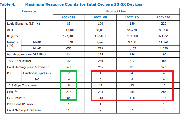

We are searching for an FPGA that is economical in terms of power.
In the past we have seen, that many devices share a common die and only restrict the resources artificially.
When looking at static power you
"pay" for all that is present and together with high  temperatures this gets ugly fast.
There is a gap in the Cyclone 10 GX overview between the 85 device and the rest in respect to the number of transceivers etc. so we hoped, that it might be a separate, optimized device (in the same way as Xilinx has just presented the ZU1 to address the lower ranges).
The early power estimator (Excel sheet) won't change the static power
when you switch the devices but I still hoped for something like
"We've done the ES chips
with the big (common) die at the start"
It might be that all this information is somewhere available - in that case please excuse my unnecessary questions. It is however a crucial question at the very start of a project
