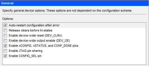

3. Go to Assignment → Device → Device & pin options → General. Ensure that the correct check-boxes are ticked.
Note:
- Enable nCONFIG, nSTATUS and CONF_DONE pins must be ticked so that they can function as configuration pins in user mode (nCONFIG is usually use to reset the device). Otherwise, they are available as user I/O pin during user mode.
- Do not tick on “Enable JTAG pin sharing” as you might lose access to JTAG pins in user mode due to improper settings.

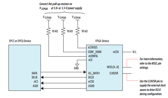

This is a configuration scheme in which the FPGA devices are configured with data stored in non-volatile serial configuration device known as EPCS/EPCQ/EPCQ-L. EPCS is usually for older devices while EPCQ that has larger density is usually used for newer devices. EPCQ-L is exclusively for Intel Arria 10 FPGAs due to its low power requirement. These serial configuration devices feature a simple four-pin interface and a sample connection is shown in the diagram below. This scheme is considered the simplest configuration mode available after JTAG. It is called an active configuration scheme because FPGA is the master and controls the configuration process.
Note: Image taken from Cyclone V handbook. Other devices might require the resistors to be pulled up to different VCC. Please refer to the respective handbook/Pin connection guideline.

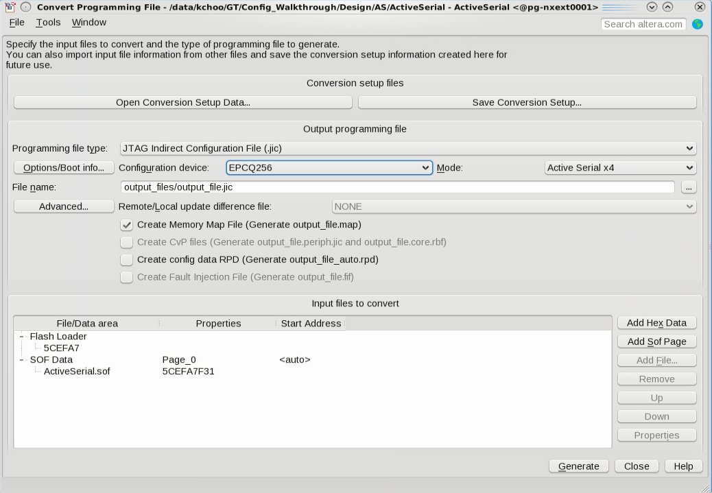

The Cyclone V E development kit is built with only the JTAG port connection. Hence in order to program the EPCQ device via the JTAG header, we need to generate the required programming file: JTAG Indirect Configuration File (.jic)
1. Open the Convert Programming File GUI by going to File → Convert Programming Files
Notes: - Make sure the mode chosen corresponds to the Quartus setting you set previously - Select the correct configuration device (it should be the same with the one soldered on the development kit) to avoid programming failure.
3. Generate the .jic file by clicking on the generate button.

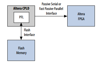

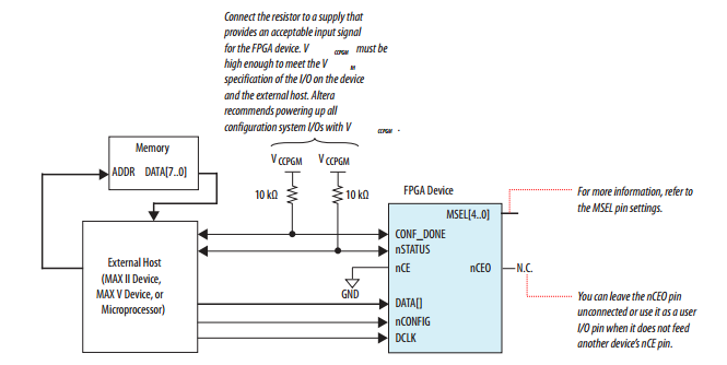

FPP is another configuration scheme where the FPGA device is configured with configuration data stored in external flash. In this scheme, the configuration process is controlled by an external host/microprocessor hence it is known as a passive type of configuration scheme. This allows the microprocessor to change the target FPGA device’s functionality while the system is in operation by reconfiguring it. This scheme is considered the fastest among all the configuration schemes as the data transfer occurs over several data lines (8-, 16- and 32-bits data width) which in turns leads to shorter programming time. The figure below gives a general idea on the relationship of the microprocessor, external flash and the FPGA:

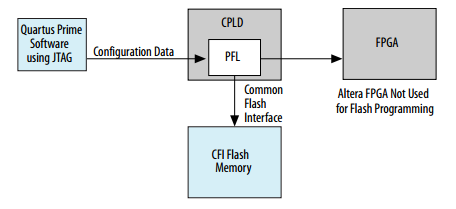

Altera provides Parallel Flash Loader (PFL) IP core that is able to program and control FPGA configuration with data from external flash. This walkthrough will focus on the PFL IP’s implementation in Intel CPLD which will act as the “brain” to control the configuration process.
PFL IP core when instantiated in Altera’s CPLD is capable of programming Common Flash Interface(CFI) flash, quad Serial Peripheral Interface (SPI) flash or NAND flash memory devices via the device JTAG interface. It then controls the FPGA configuration process by facilitating the data transfer process from either one of the flash formats stated above. Below are two figures that show the programming and configuration process respectively.

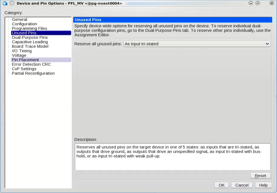

3. Go to Assignment → Device → Device & pin options → Unused Pins. Ensure that the unused pins are reserved as input tri-stated.
