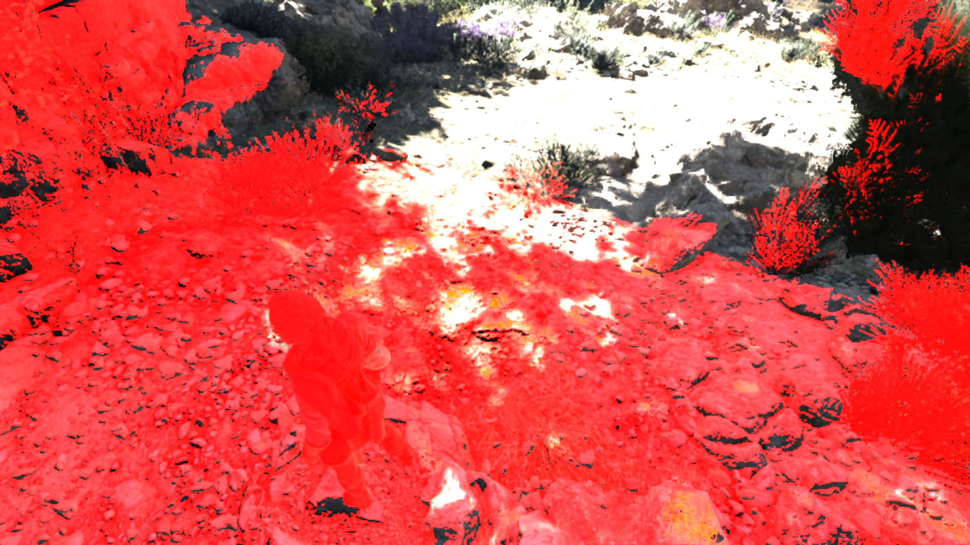

Hello Intel Support,
Whenever i run Plague Tale:Requiem, my screen turns red overlay and after some tinkering with ingame settings the red overlay keeps on appearing while near sunlight ingame. I have also seen the same problem  happen in most intel UHD graphic cards in both high end and low end devices.
I am using a 10th gen Intel Core i3-1005G1 CPU @ 1.20GHz 1.19 GHz with Intel UHD Graphics
I did find some issues related to this and apparently  no fix was found : https://www.reddit.com/r/APlagueTale/comments/zshecm/did_anyone_else_get_a_red_screen_overlay_when/
Through disabling the post processing option in config file in folders i was able to reduce the red hue by a little
Game Version is V1.6.0.0 (20230706_1126)
I am using the latest version of Intel UHD Graphics Driver as of 7/31/2023 and that is 31.0.101.2125
I have not found a issue like this on any other games
The game runs on Zouna engine
May you help me on this at the earliest

Alpha25, Thank you for posting in the Intel® Communities Support.
We are sorry to hear about this issue and we will be more than glad to assist you with this matter.
In order for us to provide the most accurate assistance on this scenario, we just wanted to confirm a few details about your system:
Is this a new computer?
Did "A Plague Tale Requiem" ever work fine on this specific machine without the screen turning red?
Did you make any recent hardware/software changes that might cause this problem?

Thanks for responding to my query,
- And for your question, No my computer in not new. Its been about 2 to 3 years with no glitches like this in many games i have played till now.
- No, the glitches were in the game from the time i installed it in my windows system.
- No, i did not any hardware or software changes recently that will impact the game negetaively.

Alpha25, You are very welcome, thank you very much for providing that information and the SSU report.
When it comes to games, it is very important to mention that we always suggest to verify the game requirements to make sure your system complies with them. Keep in mind that the performance will depend on the game specifications and your whole hardware configuration. Games are usually GPU intensive, so you may require a dedicated graphics card compatible with your system when using a desktop PC.
Based on the information shown in the SSU report, the graphics driver version currently installed in your machine is 31.0.101.2125, which is provided by Intel®:
https://www.intel.com/content/www/us/en/download/776137/intel-7th-10th-gen-processor-graphics-windows.html?wapkw=1005g1
It is noteworthy to mention that it is always recommended to install the graphics driver provided by the manufacturer of the computer, since that driver was customized by them to work with your specific platform.
I looked on Dell's website and the latest graphics driver version they have available is 27.20.100.9365, A01. Please try a clean installation of that driver following the instructions in the links below:
https://www.dell.com/support/home/en-us/drivers/driversdetails?driverid=xgd4r&oscode=w2021&productcode=inspiron-15-3593-laptop
If the problem persists after that, then try a clean installation this time of Intel® graphics driver version 31.0.101.4577:
https://www.intel.com/content/www/us/en/download/726609/intel-arc-iris-xe-graphics-whql-windows.html?wapkw=arc
We also advise to get in contact directly with Dell support to make sure the latest BIOS version is currently installed in your machine or, if necessary, to gather the instructions on how to update it:
Once you get the chance, please let us know the results.

Sadly none of the above solution worked.
