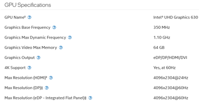

Thank you for promptly providing the SSU scan and detailed responses to each of the questions. Based on the information you've shared, I can see that you've already tested multiple driver versions (including 31.0.101.2121, 2135, and 2115) and properly used DDU between installations, which is excellent for isolating potential driver-related issues.
When using the Intel® UHD Graphics 630, the maximum resolution it can support is 4096 x 2304 @ 60 Hz via a DisplayPort connection. If you are experiencing a resolution of 1280x720 on a 1440p monitor, it may be due to incorrect settings or limitations in the configuration. For reference, go to Intel® Core™ i5-8500T Processor. Once you visit the link, scroll down to the Processor Graphics section, where you will see the maximum supported resolution of the CPU. Ensure that the correct display settings are applied and that the monitor is properly connected (try to use a DisplayPort cable) to utilize its full resolution capabilities.

I do have some DP cables but unfortunately, the motherboard Asrock H370M-HDV is one of the cheapest one on sale and only come with one 1.4 HDMI Port and one VGA port, no DP port.
On the other hand, I brought my personal 2560x1440 AOC Q27G4ZMN and tested it on my sister computer and got 2560x1440@60Hz
