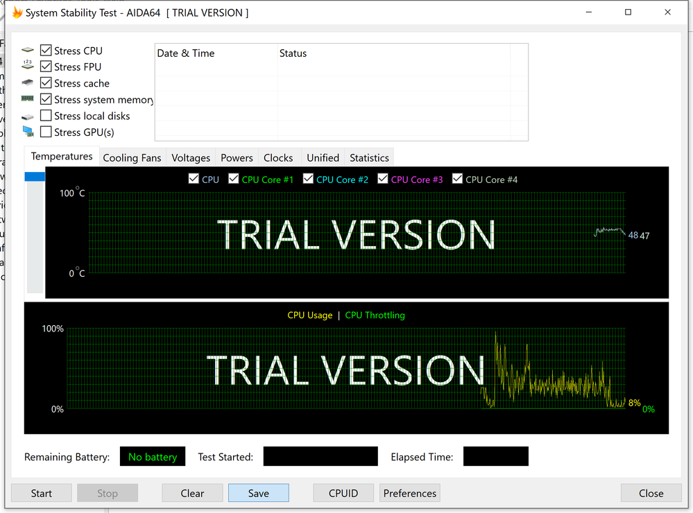

While my earlier response to this post is for some reason "pending review," here's what AIDA64 reports while playing 4K video fullscreen.  Not sure these temperatures would cause throttling...
Temperature handling looks ok - so far. Add graphics (and disks, if you have any NVMe) to the test and see if this changes anything.
What we'd really like to do is leave this running (in mode where it continues to chart) and play your streamed video...
What I posted was while playing the offending video, not while running the program's own stress test. I tried the stress test and I don't see temperatures above 55-60F.

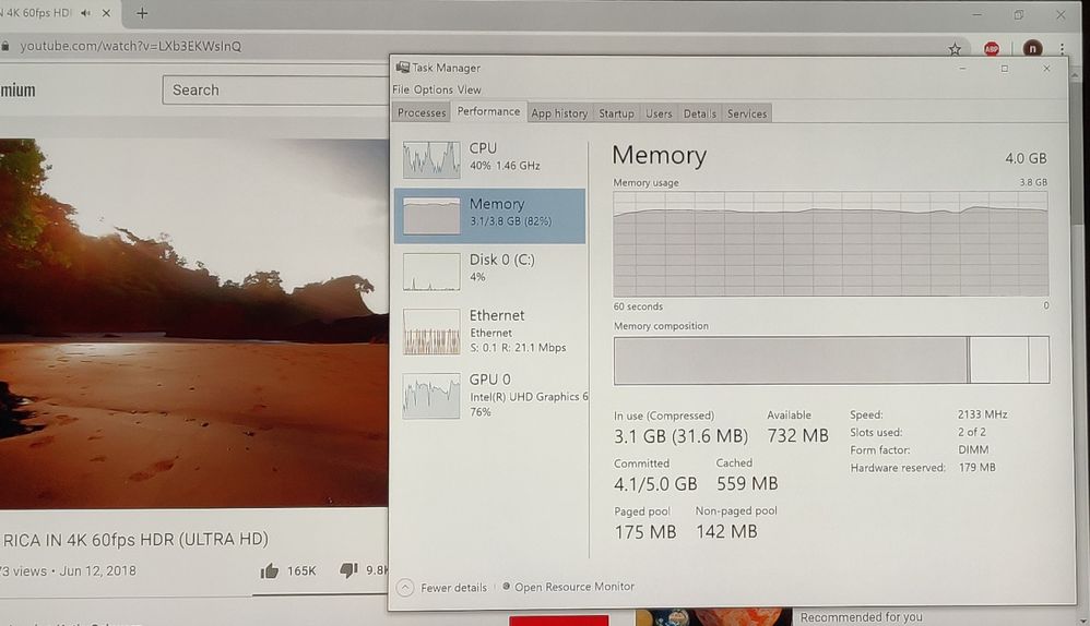

In any case, upon further testing, 4K content on vimeo plays smoothly, and so do many other 4K videos on youtube. Youtube's "stats for nerds" show that I get stutter only at 60fps.
You mentioned throttling by ISPs... I'm in the States and I have two more computers hooked up to the same router and both play the same content perfectly smoothly. It could all be as simple as not having enough RAM...
As far as I'm concerned, mystery solved. I should have looked at RAM usage right away...
There are reviews of similar small PCs with CPUs having UHD 600. Non of what I've noticed reported about non-freezing in youtube 4k 60 fps HDR, including when RAM was >4 Gb. As for RAM, mb it works too slow for that mode.
