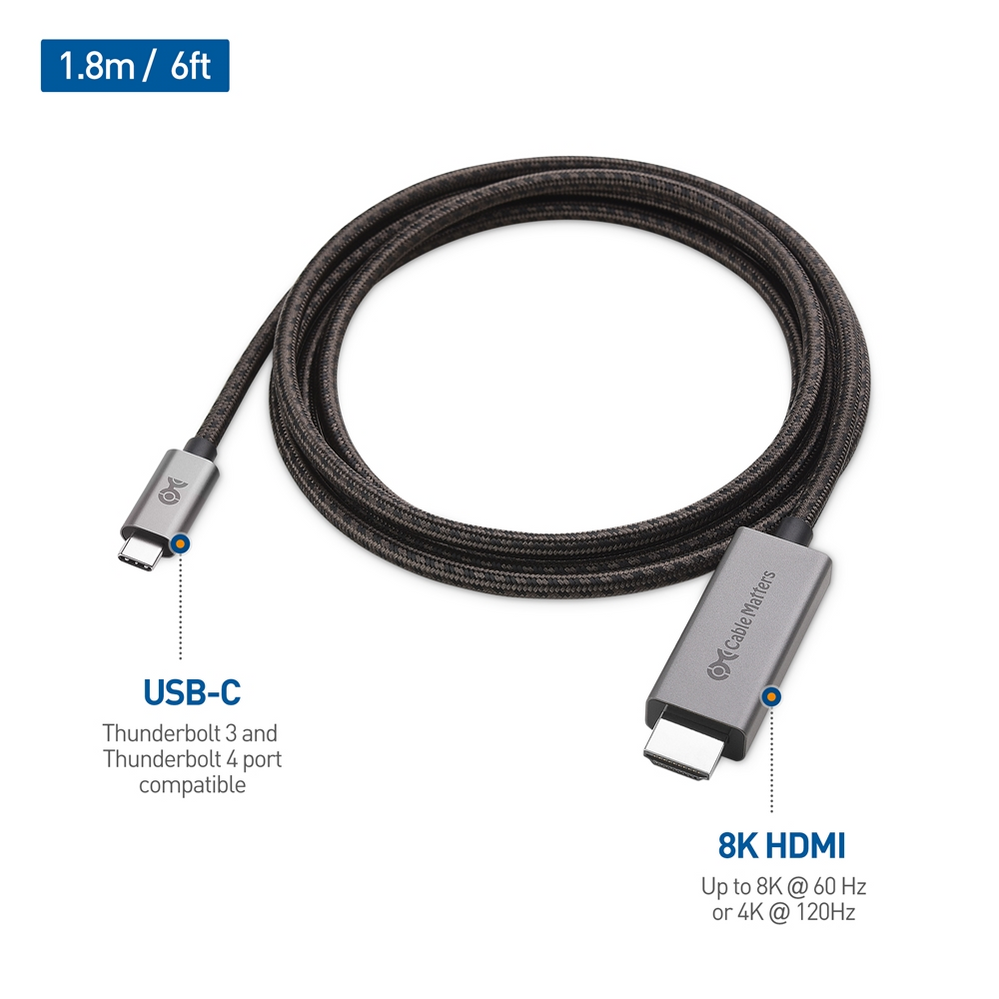

4K @ 120 Hz on external monitors are supported by Intel Graphics since Intel Iris Xe was released (2020 - 2021).
Intel Core i3-1215U Processor contains UHD Graphics capable of a max resolution of 7680 × 4320 @ 60Hz (8K). The PHY (physical layer) is compliant to the standard DisplayPort 1.4a HBR3 signaling including Display Stream Compression (DSC).
Thunderbolt (USB Type-C connector) is capable of tunneling DisplayPort 1.4a HBR3. I use an Intel NUC11 which was introduced in early 2021 together with this:
Product
Connection
Chip Type
Current Firmware
Cable Matters 201362-A
USB-C > HDMI 2.1 FRL
VMM7100
7.02.120
Firmware Update
This cable contains the Synaptics VMM7100 protocol converter chip. It can provide 4K @ 120 Hz HDR 10-Bit Color Depth on HDMI connector site by transforming DisplayPort HBR3 video and audio including Dolby Atmos/DTS:X signaling to HDMI Fixed Rate Link (FRL) 40 Gbps suitable for modern HDMI 2.1 TV sets. Please note that this product may arrive with older firmware than mentioned. If it is not working correctly, a firmware update can be done through Microsoft Windows when the product is plugged. Cable Matters provide updates on their website.
However, it is up to OEMs like Lenovo to make this usable for the consumer. There really isn't a deficit in the underlying Intel technology. The signal path from the processor to ports on the device may require additional components, which the device manufacturer must consider according to market positioning, available space and pricing policy. This is not up to Intel.
The Lenovo Yoga 9 you mentioned says in its user manual:
4K @ 120 Hz RGB 8-bit = 100% bandwidth need of DP1.4
5120 × 3200 @ 60 Hz RGB 8-bit = 95% of DP1.4
4K @ 120 Hz should work with the Lenovo Yoga as well on an external monitor. If not, this is not related to the underlying Intel technology. You will have to ask Lenovo then.
