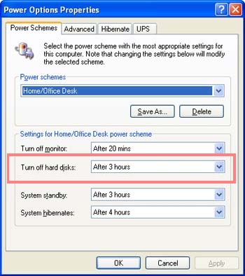

I would like to report an issue to Intel: when using "Intel Rapid Storage" version 9.6 on Windows XP SP3 32bit, the drives will NOT go to sleep anymore.
If in Bios I set SATA back to "IDE" (Intel Rapid Storage isn't used anymore), then the drives will sleep perfectly.
The data:
The board is Asus P5K-VM with Intel ICH9 controller.
OS is Windows XP SP3. In Bios, SATA is set as AHCI.
The Intel Rapid Storage driver (iaStor.sys) installed version is 9.6.0.1014.
The HDDs are Samsung HD103UJ, there exist no firmware update for those drives.
In the XP "Power Options", I set "Turn off hard disks" to 3 hours, unfortunately, the drives will *never* go to sleep after 3 hours with AHCI/ iaStor.sys.
If in Bios I change SATA back to IDE (iaStor.sys isn't used anymore) then the drives will go to sleep after 3 hours...
I can reproduce the issue _every_ time, it's consistent.
There seems to be a small bug in iaStor.sys version 9.6 that prevents the HDD to go to sleep after 3 hours.
An interesting point, using AHCI/iaStor.sys and setting "Turn off hard disks" to 15 minutes DOES work. But set to 3 hours, it won't.
Using IDE, it will go to sleep always, 15 minutes, 1 hour, 3 hours, etc...

Following up on this bug, with more testing.
I discovered that HDDs will not go to sleep if the time set for "Turn off hard disks" is HIGHER than 45 minutes.
Anything below and up to 45 minutes included put the HDDs to sleep correctly.
Anything higher than 45 minutes (1hour, etc..), will NOT work. (Hdds never go to sleep).
These results are for the Intel Rapid Storage driver 9.6 (iaStor.sys 9.6.0.1014) on Windows XP 32bit (SATA set as AHCI in BIOS) and Intel ICH9 controller.
Again, putting SATA back to IDE in the Bios, and there is no such bug: HDDs go to sleep regardless of the time set. (ie: 3 hours works OK)
-> iaStor.sys on XP will not allow HDDs to sleep if the time set for "Turn off hard disks" is beyond 45 minutes.

Here is the setting to put HDDs to sleep on Win XP:
Oohh..
It seems that "Intel Rapid Storage" version 10.0.0.1043 beta has solved this issue!I need to test more to make -sure- but HDDs did go to sleep after set time = 3 hours.. promising!- Mark as New

On a side note, I'm happy to report that IRS 10.0.0.1043 beta _DOES_ solve the problem
Because the timing in my reporting the bug versus 10.0.0.1043 release are very close, I believe an Intel IRS dev has seen this thread and managed to reproduce and fix the bug. To this person: THANK YOU!
So to sum up quick:
IRS version 9.6 had a bug on XP that prevented HDDs to go to sleep after the specified time in Windows' "Power options".
The new IRS version 10.0 solves this issue and lets HDDs go to sleep when they are meant to.
I hope IRS 10.0 WHQL isn't too far off!

After a week+ of testing, I'm happy to report that Intel RST 10.0.0.1043 beta drivers definitely solve the "HDD don't go to sleep" bug on Windows XP 32bit.
Intel, thank you very much.
