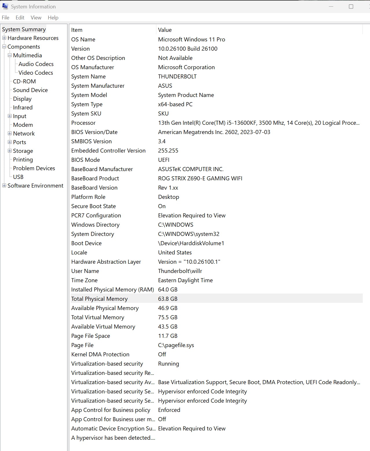

Hi Michael
Thanks for you help.
I've attached the SSU scan of my system and the system info from my machine which is probably the same but less detailed.
I have not tried manually downloaded/installed the driver. Others have said they have had that issue with manually d/l and installing.
My system was custom built so it's not a mass production machine.
I you need an additional info please feel free to reach out.
Bill
