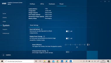

Dear Team,
I recently bought an Inspiron 7000 13 2 in 1 (7306) and I am being unable to disable the adaptative brightness in this laptop and it's driving me crazy. I only managed to solve it when plugged but not On battery.
  • There is no option in this BIOS.
  • There is no option in advanced power settings -> Display
  • There is no option in Intel Graphics Command center (NO "On battery" option).
Anyone can help? Is there any update coming soon for the command center?
Thank you so much...
No "on Battery option"No "on Battery option"

3- We understand that the screenshot you provided is when the laptop is on battery. Could you please provide another picture showing the options available when plugged into power?

3- The screenshot that I provided is to show that there is no option the move between "Plugged In" and "On battery", what we lack is the On battery option, since Plugged in we don't face this problem (we can disbale it). I'm attaching an example with a person that can move between options (not mine since I don't have the "On battery" option).

Adaptative brightness (also called Display Power Saving Technology (DPST)) is an Intel feature that needs to be enabled or disabled by BIOS, where usually is called "Ecopower" on Video Features there. We lack this option, so we need a BIOS update with it as DELL with some many models facing the same problem (like it happened here: https://www.dell.com/community/XPS/XPS-13-9370-Disable-Dynamic-Brightness-Control/td-p/6123512)
