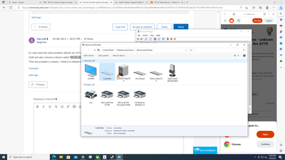

hi, I also have the same problem. (driver ver. 4314 , 4335)
Until one day I remove a device called "NF I2C Slave Device" on the page of Devices and Printers.
Then the problem is solved... I think it is related to a conflict in this device.

i don't know... but i remove it and the issue had been solved.
this device seems related to the rgb control of the arc gpu, did u install it yet?
i found it in the device manager that is NF_I2C_Compatible_Device
if u found it, try to delete and/or reinstall
hope it can help~
