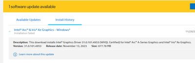

Sierbahnn
2,818 Views
Oh how the plot thickens.
I installed the Intel driver manager and it tries to install the drivers, and fails.
I get no further information other than that it failed, so it appears just not to run.
Hugo_Intel
2,794 Views
Hello Sierbahnn
Thank you for posting on the Intel Communities. I know it can be frustrating not to get a display from your DP monitor, but I will be glad to assist.
Based on your findings the issue might be related to the driver not getting properly installed on your system, so the first recommendation I can provide would be to uninstall the current driver using Display Driver Uninstaller and since you had a previous Nvidia GPU use the same tool to uninstall those drivers as well. Once the drivers are removed download and install our latest driver version 31.0.101.4972.
If the issue continues, please share with us a log file from the Intel® System Support Utility so we can get your system specs and driver details.
Hugo O.

Sierbahnn
2,732 Views
I have never gotten an error message from the installer itself. It only works for a bit then closes down.
The only indication I have that it has failed (other than the adapter not coming up named, and functions like the second monitor not working) is the notice on the Intel Driver manager, which I pasted in one of my earlier posts.
I have used that driver before, I think, and the Driver Manager also downloads one on its own, and I assume it is the same one.
