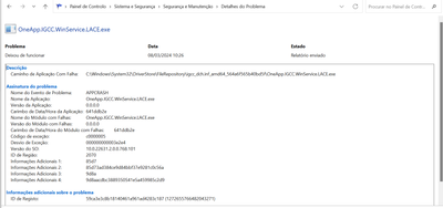

franciscomnunes
2,595 Views
Hi Norman,
Thank you for your answer.
I don't remember which one was it (and I don't think I can verify which one was it), but I believe it was related with IGCC.WinService.Lace
Thank you!
NormanS_Intel
2,581 Views
Hello franciscomnunes,
Thank you for your response. It appears you are referring to the Intel® Graphics Command Center (IGCC). You have the flexibility to either uninstall it or continue using it alongside Arc Control. The IGCC offers the ability to adjust display settings such as resolution, refresh rate, and video preferences. On the other hand, Intel Arc Control provides features like automatic driver updates, performance tuning, and game streaming. For more details, you can check our Differences Between Intel® Arc Control, Intel® Graphics Command Center, and the Intel® Graphics Control Panel article.
Still, I'd like to know if you are still experiencing BSOD and system crashes. If so, please inform us. Additionally, if you suspect that IGCC might be contributing to these issues, I suggest reinstalling the graphics driver and the IGCC application. For detailed instructions on reinstalling IGCC, please refer to our guide, How to Install the Intel® Graphics Command Center From the Microsoft Store. We're here to assist you with any further concerns you may have.
