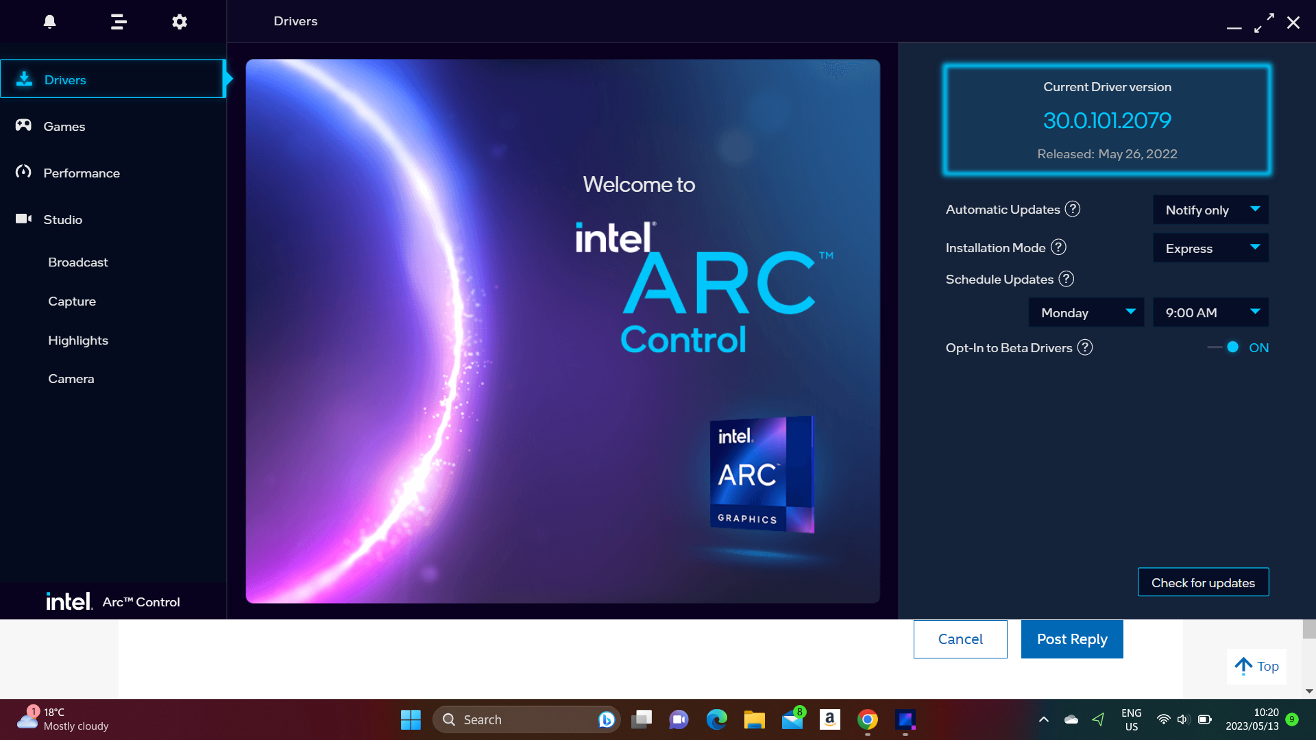

No the graphics driver is this, screenshot below
30.0.101.2079
Ok I shall try to intall driver version 30.0.101.2111
Already had this driver version, nothing changed 30.0.101.4314
