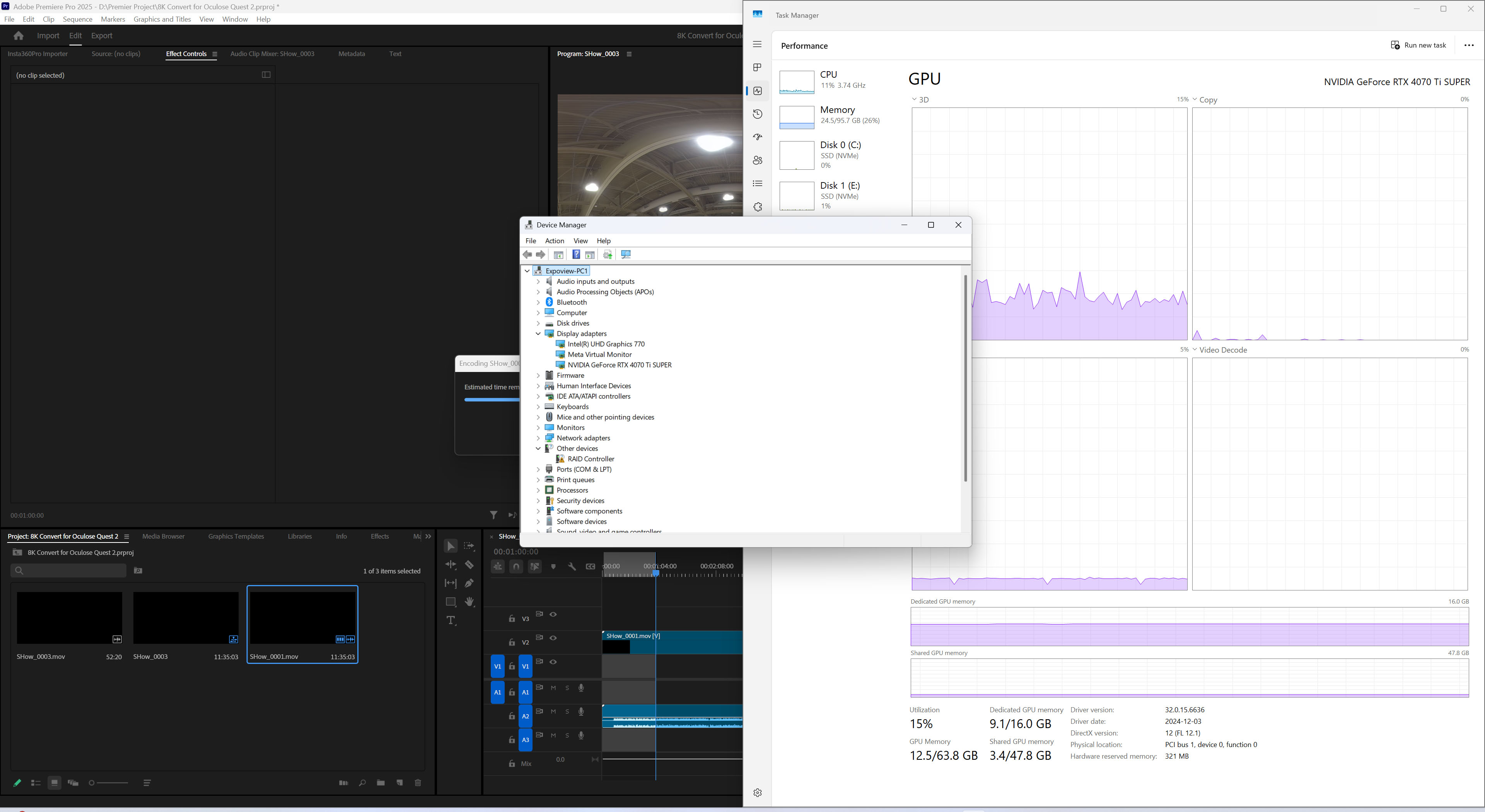

Has anyone come across conflict on Windows 11 24/H2 which causes the Intel  iGPU to be disabled?.
Even if enabled in bios the iGPU no longer can be seen to decode video footage such as H264/ H265 (no activity in Task Monitor)
This has been reported on the Adobe Video Community and trying to get to the bottom of what the issue is.
Normally the Intel  iGPU works alongside the discrete GPU to decode footage to share resource load and optimise efficiency.
Windows 11/23 does not have this problem and works normally with the Intel iGPU

Let me try to explain this.
On the Adobe Users community for Adobe Premiere Pro Video Editing Application users - we have noticed that many users updated to Win 11 24h2, then Adobe released a new version of Premiere Pro 25.1.
The earler version of Premiere Pro 25.0  (on Win 11 23H2) used the iGPU in parallel with a RTX Nvidia based discrete GPU.
If you were exporting a video and using the iGPU to decode H264 or H265 - then the NVidia GPU was encoding in parallel (eg to a new codec)  with some work done by your CPU such as a 14900K or 13900K (Intel 770 GPU)
Then it was noticed on Win 11 24H2 that iGPU stopped decoding.
Some users (including myself) spotted this article on Tom's Hardware, but it mainly talked  about Intel Ultra CPU's
https://www.tomshardware.com/pc-components/cpus/z890-motherboards-are-having-instability-issues-with-windows-11-24h2-bios-updates-or-disable-igpud-required-to-update-windows
ASUS also published a technical note about the Z890 chipset and Win 11 24H2, but they said it was possibly affecting other chipsets such as Z690 etc. No info at that at time of writing this.
For Z890 the workaround was to 'disable' the iGPU in BIOS for Win 11 24H2 users. This is not a fix !.
https://www.asus.com/support/faq/1054046/
There is a conflict on some chipsets such a Z890 stopping simultaneous decoding/encoding of Intel iGPU and NVidia RTX GPU such as 4080 ..
Further tests since have revealed that on the latest Premiere Pro release 25.1 the  iGPU will not decode H264, but it does decode H265 - even exhibiting this problem on Win 11 23H2 as well as Win 11 24H2.
Going back to Premiere Pro 25.0 it does decode H264 and H265 in parallel with RTX NVidia 4080 etc. However if you had a Z890 chipset using Win 11 24H2 it is likley your iGPU will have been disabled in BIOS. (See above note from ASUS)
I also raised a case with Microsoft Windows support who told me there are known conflicts with Win 11 24H2 and some Intel chipsets but they were non specific !!.
So there has been much confusion on statements issued on Win 11 24H2 conflicts, plus what also appears to be problems on Adobe Premiere Pro latest release 25.1 using the iGPU (found by the user base).
No manufacturer has given an updated clear statement so far on this, so we, as users of Intel hardware, MS Win 11 operating system and Adobe Video editing application are in the dark on what is going on.
Several users have reported all the above problems in both Desktop High end systems and some Laptop systems.
Not having iGPU and dGPU functional in parallel will causes degradation in performance when working with H264 and H265 footage.
We have reported bug issues to Adobe on their latest 25.1 release for Premiere Pro, since this does not use iGPU to decode H264 fottage like it used to. It does decode H265. Awaiting feedback.
However,  having some form of CLEAR statement on any known issues for Intel chipsets and Win 11 24H2 conflicts for iGPU and dGPU would be also beneficial to reassure customers.

To further investigate the issue, please obtain the following:
  1. Kindly provide us the Intel® System Support Utility for Windows* logs. Ensure that "Everything" is selected.
  2. A screenshot of the Device Manager showing the drivers under "Display adapters."
  3. A screenshot of the Task Manager displaying Video Decode.
  4. Recommend loading the BIOS to default settings and check for any changes.
Earl E.

Rez1
9,085 Views
Hi Earl,
I have the same problem that stressedout-tek mentioned. Since two weeks ago, when I put this computer together, I never saw any activity for my 14900k iGpu in Task Monitor, even decoding H265! I really have a concern that my iGPU is not working at all.
I confirm that in Premiere Pro release 25.1, the Hardware encoding is not available for H264, but it is for H265. As I mentioned before, there is no sign of iGPU sausage in the Task Monitor during decoding H265.
I use ASUS ProArt Z790-CREATOR WIFI BIOS, which is up to date and has set the default settings.
I included Intel® System Support Utility for Windows*  logs. For your review.
Please advise how I can check to see if the iGPU is alive and how I can make it start working.

Earl_Intel
7,920 Views
Hello stressedout-tek and Rez1,
Thank you for patiently waiting on us.
Upon further investigating and testing, we can confirm that such issue exists in Adobe Premiere (Adobe Encoder also), but it's not related to Intel driver, screen or video setting involving Intel driver.
So, it's best to contact Adobe regarding this issue.
