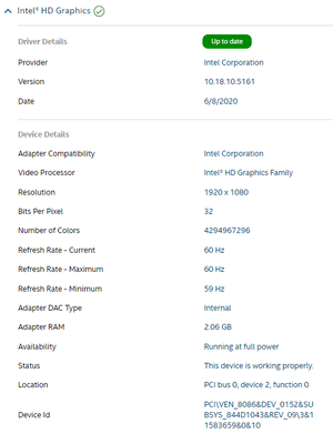

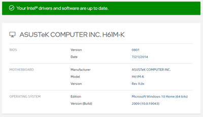

We need more information. Please download and run the Intel System Support Utility for Windows. Select all data categories and then have it generate a report. Next, have the tool Save the report to a text file (don't try to use the Submit capability; it doesn't work). Finally, using the Drag and drop here or browse files to attach dialog below the edit box for the body of your response post, upload and attach this file to the response post.
DaLucsta
7,715 Views
Hi Scot,
Thanks for your swift reply.
Please find attached the file you requested.
Luc Richter
n_scott_pearson
7,700 Views
I am not seeing anything that stands out in the report. Can you run the tool again, this time selecting all of the data categories? This will give us Event Log entries. Generating report from DXDIAG tool might tell us more as well.
DaLucsta
7,697 Views
Hi Scott,
Thanks again.
Please find attached SSE ASUS3II.
Luc
n_scott_pearson
7,692 Views
Nope, nothing jumps out at me in this version of the report either.

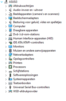

Either (a) the monitor on the DVI interface is not being seen at all or (b) it is being seen but the display is blank. Are you seeing entries for two monitors in Device Manager?
DaLucsta
7,680 Views
Hi Scott,
No, as you can see below in the partial printscreen, a second monitor is not showed.
The word ´Beeldscherm´ means ´Display Settings´.
Can it be concluded 'the DVI part from the video card' is broken,  since the VGA-monitor (the first) does to be working?
And that's what occurs strange to me since the system, even the SSU report (!), doesn't show any errors?
Please, enlighten me?
