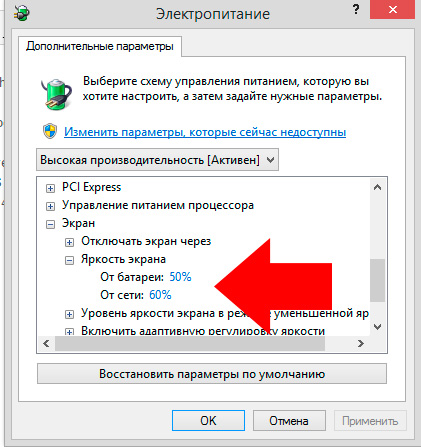

I've got the problem with brightness control on my laptop. Now it's only 100% brightness and all methods from this forum or other else doesn't resolved this issue.
When I try to increase\decrease brightness (Fn+F4 \ Fn+F5) - it's changed only in Windows settings (see attached fig.1)
1. Adaptive brightness in Windows Power settings is SWITCHED OFF.
2. When I choose the Default Windows video driver - brightness control works perfect.
3. With Windows 8 and old Intel driver - it was worked, but now it's Widows 8.1)
So, I'm sure the issue with Intel HD 400 drivers. Please help me to resolve!

For the Fn+F4 and Fn+F5 key combination and all other Fn+Fx keys, the problem is not with the graphic drivers but with the Dell quickset app. If it's not installed go to the Dell download site for your laptop and download/install the quickset application.
The problem not in Fn+ keys combination. When I'm trying to change brightness in Windows Power plan menu - seems the same issue, doesn't work... And please read my first message: when I change the 'Display Adapter' settings to Default Windows adapter - the brightness control works perfect!
