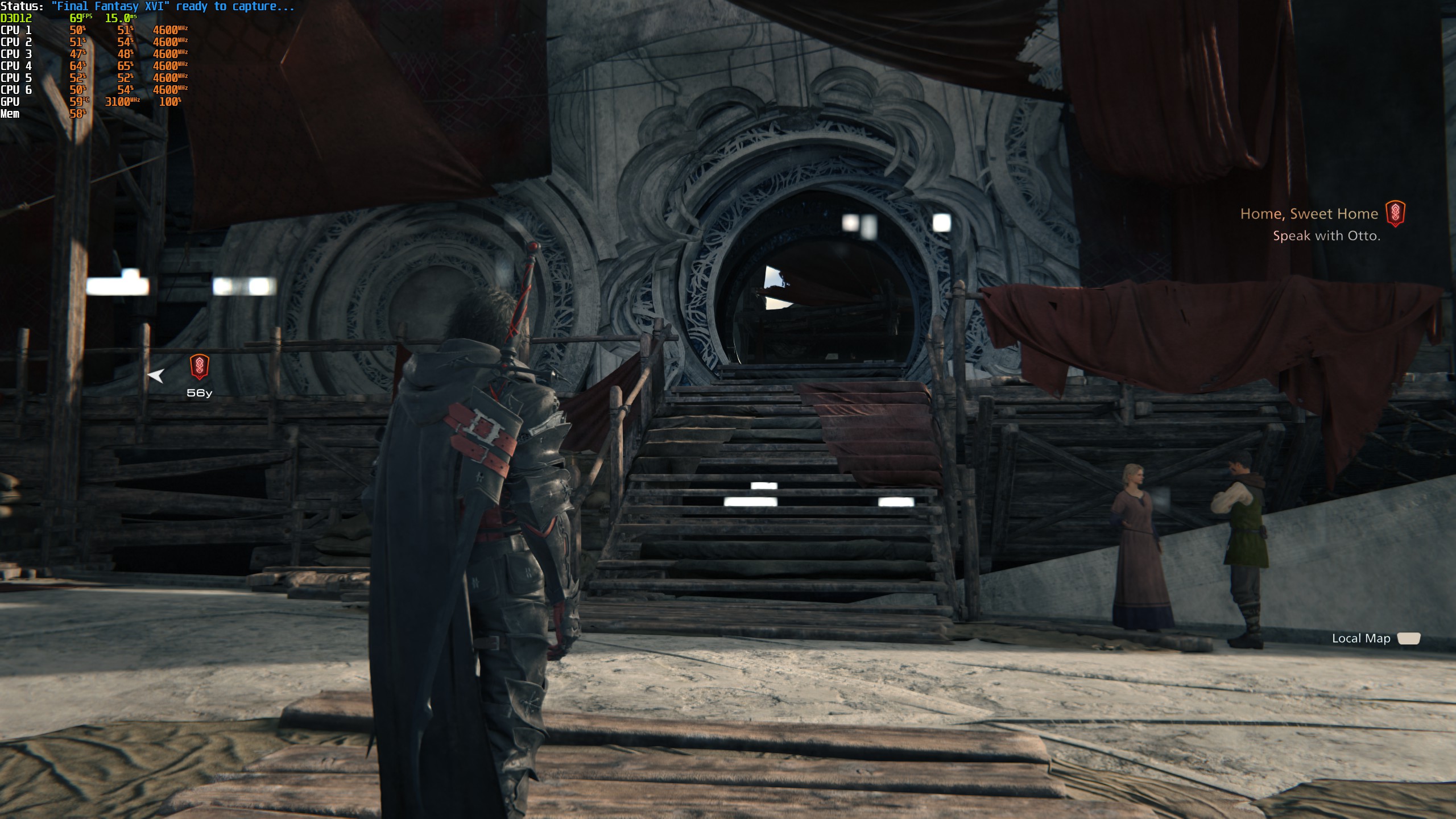

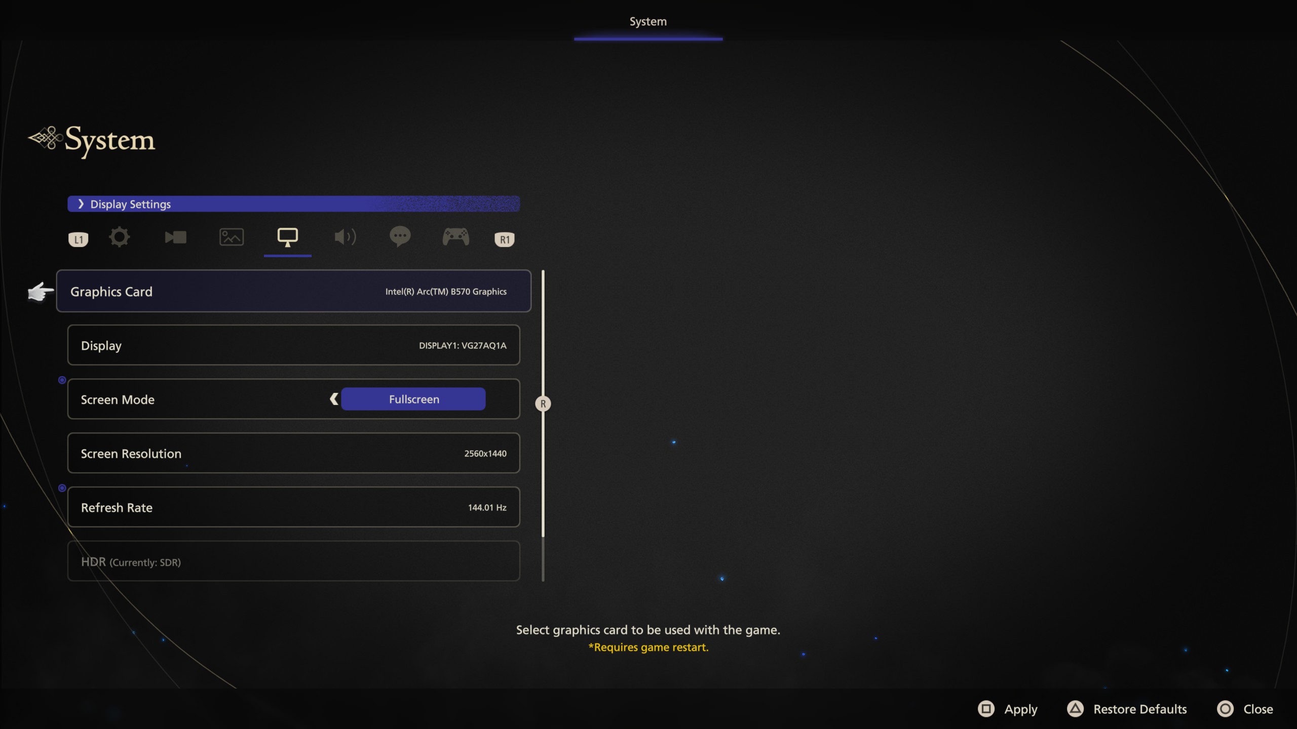

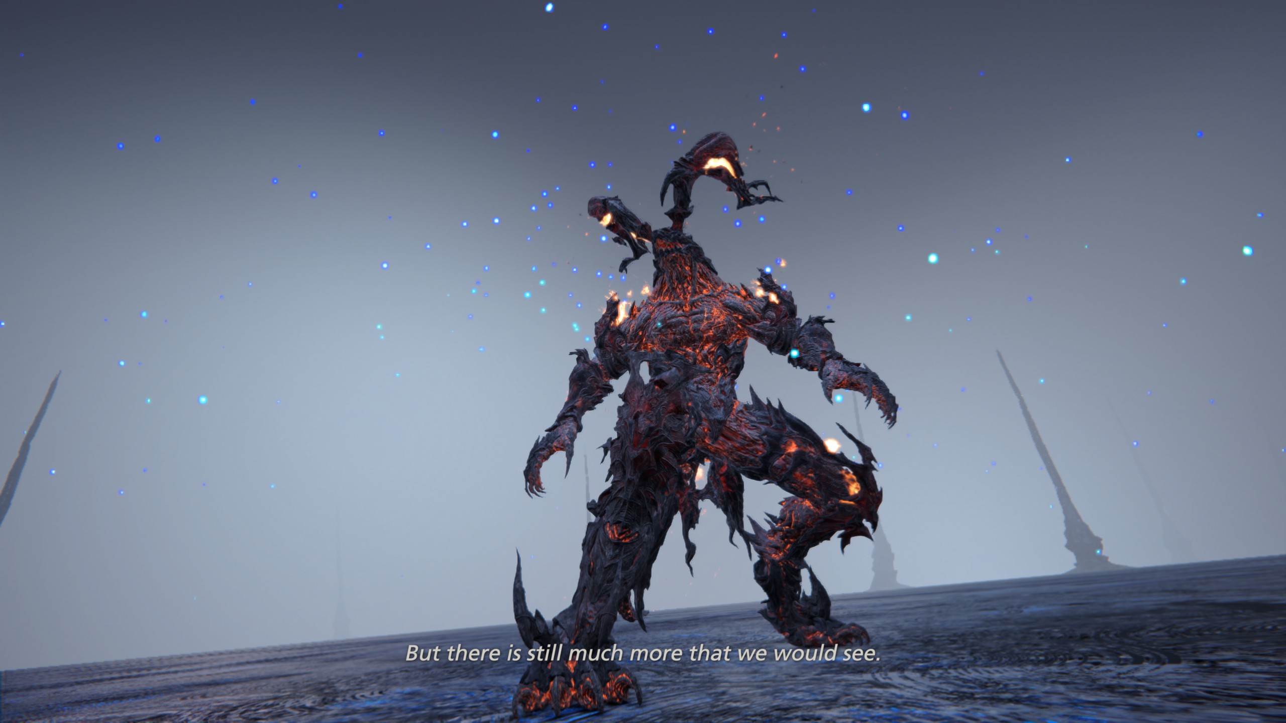

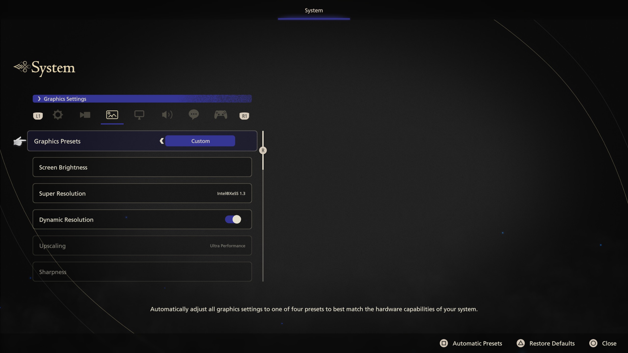

Thank you for your message. I have to admit a mistake, I seem to have had an overclock applied when my game was crashing during my gameplay when I made my inquiry. I was sure that I did turn off any overclock settings I had made to try to get smoother framerate in the game. I turned the OC off after I managed to get through the part that had been crashing. I can't remember if I had overclocked when I first got the b570, which was when I was at an earlier part of the game (where the game continues from the demo to the full game). which caused crashing in The Hideaway area for example and the battle against Jill. I did try to see if the Typhon which was the most recent part my game would crash at would reproduced a crash with overclocking settings turned off. There was no crash but oddly there was artifacts in the rendering. I attached images of my settings, and the described scene rendered properly and with the artifacting.

Hi RandyT,
Thank you for your response. I figured it was simply the case that the game isn't optimized, and that a driver update can't just make it smoother 😓. As for the graphics corruption, it doesn't happen very often at all, only once when the B570 was stable. As for locations where it can be observed. The very same tavern scene I mentioned, I saw in the village the corruption happen, and in the area in the quick-save. I would like to clarify that the screenshot of the corruption was at stock clocks. I have screenshots of the same corrupted visual when testing an overclock. Additionally I have an older screenshot from the start of the game "Hideaway" hub area where the corruption took on a different appearance (green flares, purple shading). Overall, I don't suspect that the corruptions are a real concern if they really only happen with overclocked settings.
