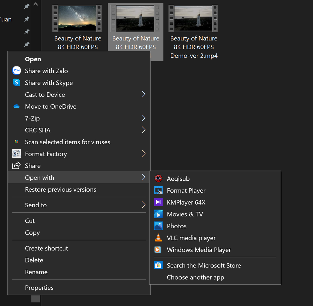

Sorry for late reply, may laptop has problem and need send to repair.
I create new share link of this video, please download in below link:
https://drive.google.com/file/d/1UDtr3NHoIYg22mp-ULZrJs3wl_7wZ352/view?usp=sharing
I answer some your questions.
-VLC player cannot play video 8k 60FPS in google link above, the video stop at the first frame. However, the time still count up/run (please view attched photo)
-The built-in display of my laptop is UHD 4K.
-I downloaded the same video 4K "jellyfish-200-mbps-4k-uhd-h264.mkv", video play smooth, no problem.
In my opinion, Intel HD Graphic 630 can play 8K 60FPS video on youtube if we build better driver for it. The Graphic can play video 8K 60FPS, just sometimes stop/lag a very short time.
