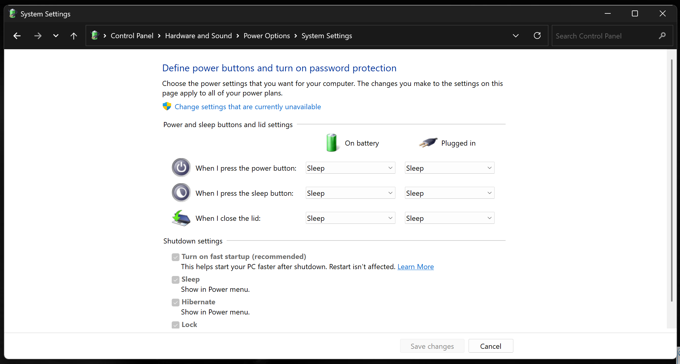

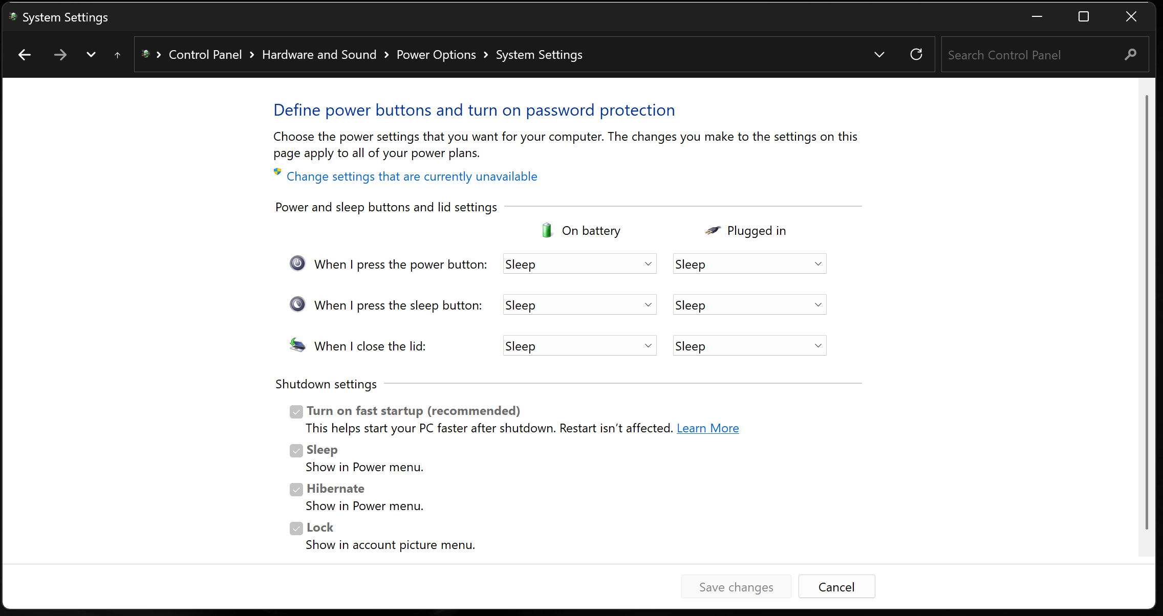

Dear Intel Team,
I am using HP Spectre X360 laptop which graphic card is Intel.
After updating latest Windows version 24H2, I have a problem.
Scaling default from laptop is 200%, and when I start the laptop, scaling is going over 200% and mouse pointer and become very big, although it is shown in display setting still 200%.
Each time after opening laptop, I have to set scaling for example from 200% to 175% and come back again 200%, so that I can fix the issue.
When I restart the laptop, the issue is not hapening, but when I close and open again the problem occurs every time.
Now I found a temporary fix, I did disable the fast start option from laptop, and the problem did not occur again.

With the provided information you have shared, it appears that the issue is indeed tied to the Windows 11 24H2 update and its interaction with your system's scaling and cursor settings.
Disabling Fast Startup, as you've done, is a valid workaround. While it is not ideal, it ensures the scaling issue does not reappear until a permanent fix is implemented.

I turned off "Fastboot" and used pc about week when again turn on "Fastboot" and about week using pc without any issue, but today windows boot with huge mouse cursor.
Thank You
