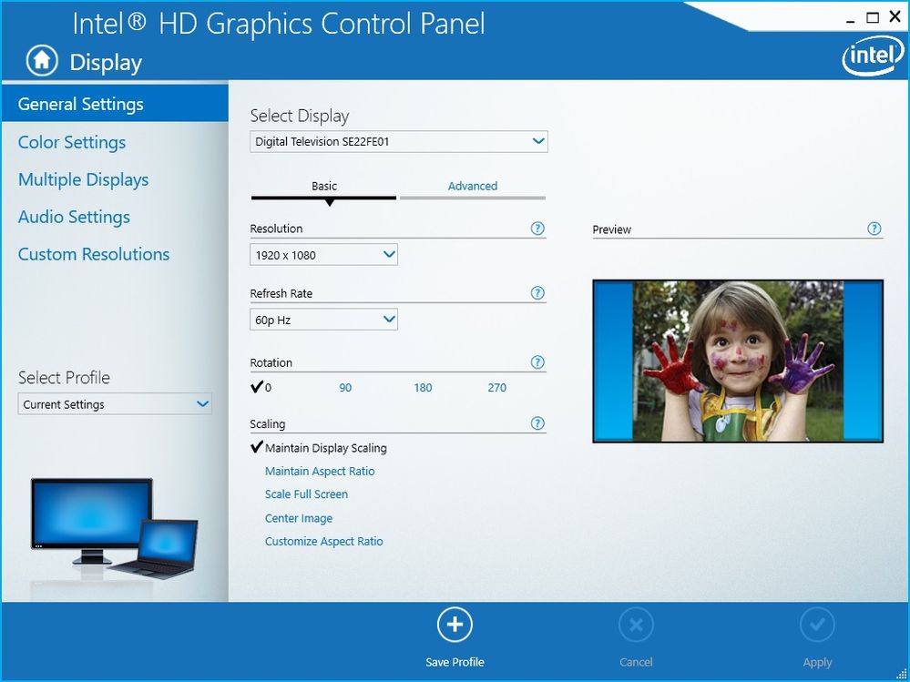

I am seeing it say that you are configured for an 59i Hz (i.e. interlaced). That's bad. This should be set to 60p Hz (i.e. non-interlaced). Fix that and see if it improves things.
It should look like this:
Thanks Scott. I appreciate the help. I figured out that once I set the refresh rate to 60p Hz, the bars appeared on the side of the image and I could scale, so it's all good now. Thanks again.
