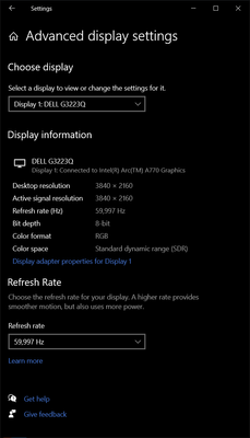

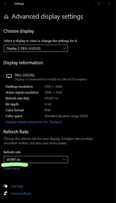

Adrian_Vasile_C_
4,730 Views
Hello
I set my monitors to 60Hz and to Landscape orientation, as instructed in the link you provided.
Adrian_Vasile_C__0-1730827605494.pngAdrian_Vasile_C__2-1730827793113.png Adrian_Vasile_C__1-1730827644448.png

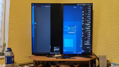

But IGCC still has the same problem:
After I combine the monitors, my flipped monitor is no longer flipped, and the image now appears up-side-down:
(I can see the monitors appear to be back in portrait mode, but I did not make the setting (I kept them in landscape mode). IGCC shows them like this after Combine....)

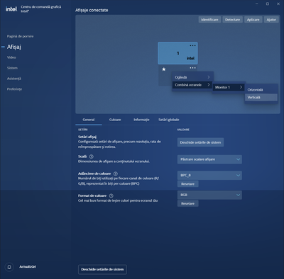

Yes, I used landscape mode and 60 Hz, here are some new screenshots, but after Combine Monitors in IGCC the image still looks bad.
Adrian_Vasile_C__0-1732116505052.png  Adrian_Vasile_C__2-1732116692368.png  Adrian_Vasile_C__3-1732116929365.png
The image looks right befre I use Combine Monitors in IGCC, if I configure the reverse monitor in Landscape (Flipped )orientation in Windows.
But right after Combine Monitors, my reverse monitor is suddenly up-side-down, though it was upright before
I can see the monitors appear to be back in Portrait mode in the photo, but I always  kept the Orientation settings to Landscape and Landscape (Flipped), as can be seen in the screenshots. But IGCC will show the monitors back in portrait mode after I use the Combine Monitors options
