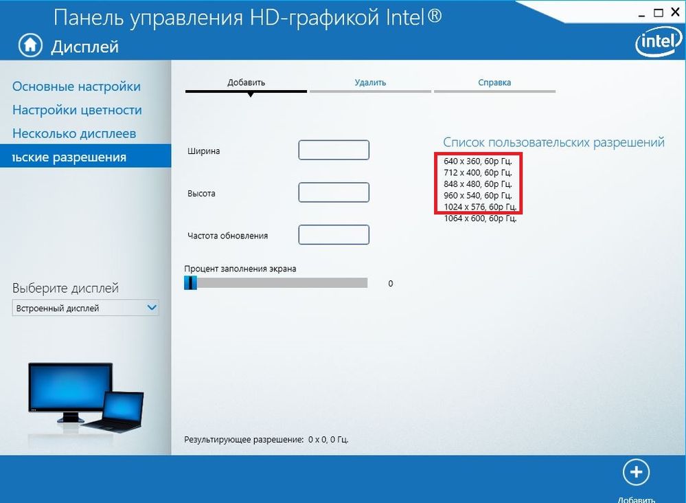

Hi. After install new driver on my HD 500 (n3350) with new graphics panel i cant set custom resolution lower then 1064x600. Now minimum resolution is 600 pixels in widht (Like 800x600?) (idk this problem only at me or at all).
With old control panel i can make yourself a list with various resolution, like 360p and 480p (640x360 and 854x480) etc. In many games my custom list show up in settings and i can get more fps. But now its gone. Pls fix this.
Excuse my English.
Screenshots, reports and video attached.

Hello AMisn Thank you for waiting. Please refer to the following information. 1. By default Intel® graphics command center (IGCC) will not show resolutions strictly less than 800x600. 2. Resolutions shown in the IGCC may not match the resolutions shown in OS page. IGCC lists all resolutions in OS page which are ≥ 800 x 600. • At the end of the drop-down list, you should be able to find “Custom Resolution” option. This should allow you to add any supported resolution to the list of existing resolutions. Note: Advanced Custom Resolution is not supported for Built-In Displays. Regards, Leonardo C. Intel Customer Support Technician Under Contract to Intel Corporation

Why do you write me this ? Read my main post and watch screenshots with video.
New panel (IGCC) not give set custom resolution lower then 1064x600. Problem in IGCC, because previous panel (Intel Graphics control panel) can do it.

Hello AMisn Thank you for sharing this information, the Intel® graphics command center is a new tool that does not allow to select resolutions lower than 800 x 600, nevertheless thank for sharing the experience so is can send it to the correct department for them to consider it. Regards, Leonardo C. Intel Customer Support Technician Under Contract to Intel Corporation
