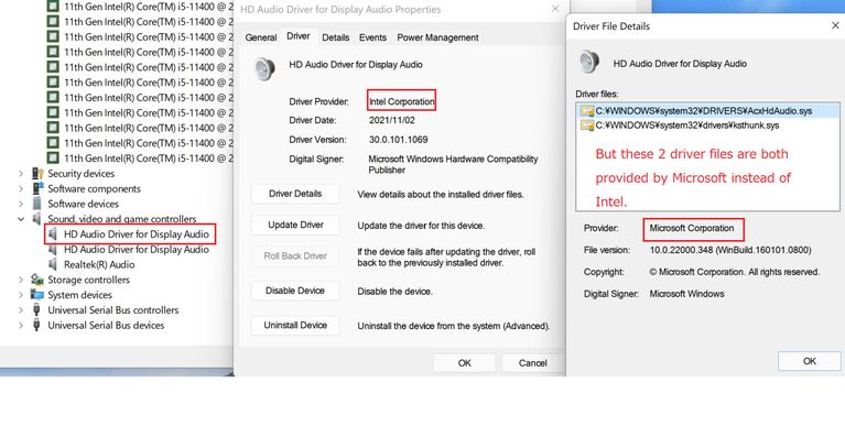

I am also confused by this issue.
My desktop PC has i5-11400 with no additional graphic card, motherboard HDMI port connects to monitor.
OS: Windows 11 pro.
Audio from HDMI works alright but with one issue:
When I play any sound, the beginning of that sound will be cut out about 0.5s.
This is fine if I play relatively long audio, say a song or a movie.
But the thing is I am an English learner and I need to play word pronunciations from dictionary apps.
For example if I play the pronunciation of the word "right", I can only hear "t".
This is critical so I am trying to find some potential solutions.
I learned that this issue is caused by so called "silent stream" bug, but it seems that Intel  has handled it many years ago?
So I tried to update the audio driver but found that there is no one included in the package of graphics driver.
As @AndyMac60 pointed out, the audio drivers in that package are only for as of 10th gen.
If I check the Audio driver in device manager, it says the driver is provided by Intel but driver files are all provided by Microsoft.
(see attached screenshot.)
I am not sure if the HDMI audio cutting out issue is related to this, just got curious why there is no audio driver for 11th gen CPUs just like previous gens?
