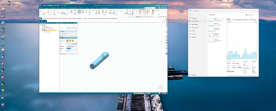

The Intel Arc A380 GPU is not being utilized as it should be with Siemens Solid Edge (not SOLIDWORKS!) 3D CAD software.
I have attached two webp videos that record the 3D CAD extruding operation with Task Manager GPU usage.
- SolidEdge.webm
When extruding a simple cylinder, the A380 GPU is only utilized around 16%.
The performance is slow, similar to the Intel UHD 730 CPU integrated GPU.
Solid Edge version is 2410.0001 (build 225.00.01.004 x64).

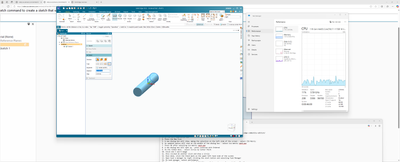

- DesignSpark.webm
I also tested a similar task on DesignSpark Mechanical, another 3D CAD software from RS Components.
This performs much better, with the A380 GPU being utilized more than 50%, and the movement is much smoother compared to Solid Edge.
Design Spark version is 6.0.3.

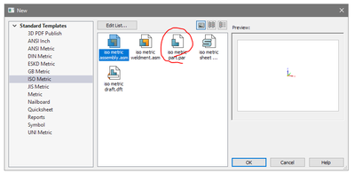

Steps to Reproduce:
Download Solid Edge Community Edition from below and install.
https://resources.sw.siemens.com/en-US/download-solid-edge-community-edition/
Start it and open a new file.
Then select "iso metric part.par".
Draw a circle then extruding.

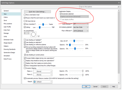

Ensure that "Application Display -> Graphics card driven (Advanced)" is set.
This is usually set by default, but please double-check.
