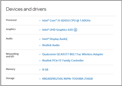

For some reason, the new Intel DSA v25.3.24.7 (rel.10-Jun-2025) is now recommending an old Intel Graphics Driver v31.0.101.2121 for 6th-10th Gen Intel Core Processor Graphics that was released two years ago on 05-Apr-2023, even though Intel DSA v25.3.24.7 correctly identifies my Win 10 v22H2 OS, 8th Gen Intel i5-8265U CPU, and other devices and drivers.
A clean reinstall of Intel DSA v25.3.24.7 using the Intel Driver & Support Assistant Uninstaller (DSAUninstaller.exe) did not solve the problem.
Intel DSA v25_3_24_7 OLD Intel UHD Graphics 620 v31_0_101_2121 13 Jun 2025.png

IDSA is a pathetic piece of software and causes more problems than it fixes.
I would stop using IDSA (eliminate it from your machine) and download the driver directly from this link:
https://www.intel.com/content/www/us/en/download/776137/intel-7th-10th-gen-processor-graphics-windows.html

it does appear that the latest Intel® Driver & Support Assistant (DSA) v25.3.24.7 may be incorrectly recommending an outdated graphics driver (v31.0.101.2121) for your system, despite accurately detecting your Intel UHD Graphics 620 and 8th Gen Intel Core i5-8265U CPU running on Windows 10 Pro v22H2
...hence, i agree to @AlHill Intel® Driver & Support Assistant (IDSA) has shown inconsistent behavior and, in some cases, appears to introduce more complications than it resolves. download the driver directly from this link intel 7th gen CPU graphics
