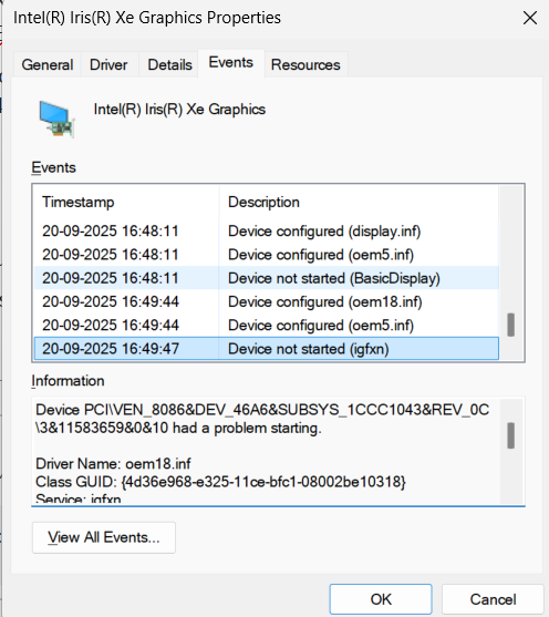

    • There are no warning signs or unknown devices listed in the Display adapters. But in the properties of the 'Intel(R) Iris(R) Xe Graphics', Event shows 'Device not started (igfxn)'
      INFORMATION:
      Device PCI\VEN_8086&DEV_46A6&SUBSYS_1CCC1043&REV_0C\3&11583659&0&10 had a problem starting.
      Driver Name: oem18.inf
      Class GUID: {4d36e968-e325-11ce-bfc1-08002be10318}
      Service: igfxn
      Lower Filters:
      Upper Filters:
      Problem: 0x0
      Problem Status: 0xC00000E5
      (Screen shot is attached)

Thank you for the all the steps you have provided but the issue still persists. The game crashes with the same error report.
Also in Device manager, it is yet saying Device not started as mentioned before. (Screenshot attached).

After the update, the game seems to be working fine, no issues there but why the intel graphics still shows device not started in the events table of its properties (As shown earlier in the screenshot). That is the only concern now. Thanks
RandyT_Intel
13,975 Views
Hi @Saboteur,
Thank you for the update! I'm really glad to hear that your game is working perfectly fine after the 32.0.101.7076 update that's exactly what we wanted to achieve. Regarding your concern about the Intel graphics still showing "device not started" in the events table, let me explain what's likely happening here. What you're seeing in the Events tab is actually a history of previous events that occurred on your system, not current active problems. Think of it like a logbook that keeps track of everything that happened before, including when we were troubleshooting your original issue. Since your system performance, gaming experience, and overall stability are all working normally now, these event entries are most likely just historical records from when the system was having problems or during driver installations and updates. Sometimes Windows keeps showing these old events even after the issues are resolved, and it can also be a cosmetic error where the operating system repeatedly logs driver detection activities that aren't actually causing any real problems.
Here's what I'd recommend if you want to investigate this further: first, could you please take a fresh screenshot of your Device Manager right now showing the current status of your Intel Graphics device? This will help us see if there are any actual current issues versus just old logged events. You might also want to try rebooting your system completely and then check the events again to see if any new entries appear. Sometimes waiting for the next Windows update can also resolve these kinds of logging inconsistencies automatically. However, if you're still concerned about these specific Intel Graphics event messages and want a more detailed investigation, you could consider submitting a new support thread focused specifically on this Intel Graphics logging issue, or even better, contact your laptop manufacturer directly since they would have the most detailed insights about how their specific hardware interacts with Windows and what these particular error messages mean for your exact laptop model. But honestly, since your original gaming problem has been completely resolved and your system is performing well with good stability, this seems to be just a minor logging concern rather than something that's actually affecting your computer's functionality.
