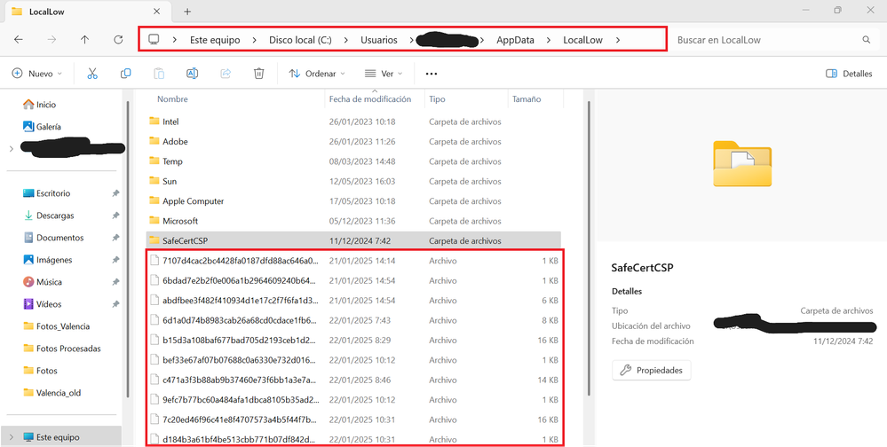

We are watching what happens to us with the latest updates to the Intel Iris Xe Graphics driver.
When we open any Win32 application, some random files are generated within the path c:\users\”user”\AppData\LocalLow
We have been able to verify that this does not happen to us in driver version 31.0.101.4032, from the one following this, it does happen to us with any of the new versions
Laptops HP elitebook 840 G8 CPU 11th Gen Intel(R) Core(TM) i7-1165G7 @ 2.80GHz
Windows 11 Enterprise 23H2 version 22631.4602
I attach a clipping as an example of my own computer, which has the latest version of the display driver installed (2025):
Also attach a clipping of the detail of the driver that my computer has installed (last published)::

Hello VonM_Intel, thank you very much for the early response and help, sorry for the delay, I will try to answer the questions you ask us.
Does this problem occur with all Win32 applications or are there specific ones where random files are generated?
We have tried several such as Notepad, cmd, bitlockerwizard, etc.
