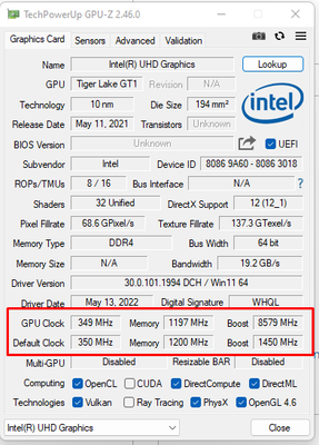

Intel UHD graphics' default clock, memory and boost doesn't match actually GPU  memory, clock and boost. This may cause low battery life time. Approximateley 1 min of browsing takes 1 percent of battery in eco mode. How may I get default specs for UHD?

The boost value is quite far out of range.
Looks like an application issue as discussed here:
https://www.techpowerup.com/forums/threads/gpu-z-2-13-intel-hd-620-wrong-gpu-clock-detected.248573/
Zhangirhan
3,079 Views
Not really that case, it is not misreading like in case you mentonied. This 2 lines should match even if it is misreading of a sensors

Hi, it is laptop NUC x15 with I7 11800hq. Just bought it. battery runs out fast, so i sterted cheching system. It is my home laptop.
Attached ssu and Intel Processor Diagnostic Tool log.

I checked with the NUC engineering team and as mentioned by @Stefan3D this is an application issue.
I would recommend addressing this issue with TechPowerUp* https://www.techpowerup.com/gpuz/

Hello. It seems problem wasin Windows 11 or its drivers. Now I have installed windows 10 and intel gpu clocks are ok. GPU-Z app version the same
