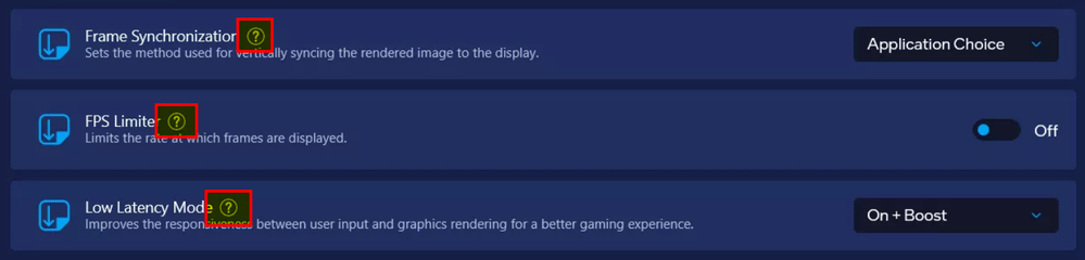

Frame synchronization also depends heavily on the game. Therefore, there's a setting that allows you to leave this to the application running the game. You'll have to test what works best for you.

There are no manuals in the traditional sense for the Intel Graphics Software. However, you can get an explanation of each setting within the application by using the question marks:

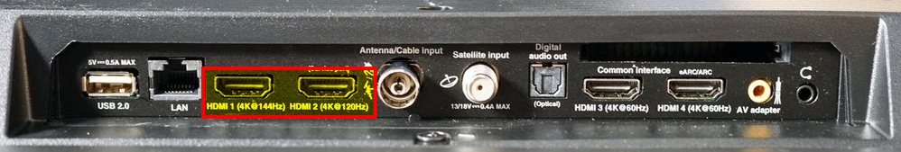

Please note that the TCL C735 does not support the same features on all HDMI ports.
HDMI 1 = 4K @ 144 Hz
HDMI 2 = 4K @ 120 Hz
HDMI 3/4 = 4K @ 60 Hz

Thank you for the reply and support. TV and PC are connected with a quality 2m hdmi 2.1 cable, of course to HDMI 1. I need to know how to adjust right Graphics and Display sections, especially the options with all frame synchronization types, color format and depth, and quantization range.
