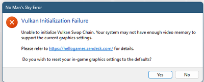

I updated my laptop's Intel Graphics driver after being prompted by the Intel Graphics Software and now every time I start No Man's Sky it gives a Vulkan error and crashes. It worked prior to the driver upgrade and nothing else changed.
Error messages:

I installed the next, (non-certified) version 6989 and it's back to normal.
When it was failing it was getting past the credits and the initial screen, then there is a screen showing something like a warp tunnel, after which it brings up the game environment. Instead of bringing up the environment it showed an all-white screen for around 15-30 seconds before bringing up the error dialog.
It was only One Man's Sky, and I did try rolling back to the last known working version, 6913, but it did not work either. I also tried repairing the game files etc.
It's in the Steam environment

It appears that the graphics driver update prompted an issue and to investigate further, please share the information below.
1. What was the last known working driver version?
2. Have you tried rolling back the driver?
3. Is the issue isolated to No Man's Sky?
4. Which game distribution platform is being used (Steam, Epic Games, etc.)?
5. Do the game instantly crash after launch?
Additionally, to have a better understanding of your system configuration and components please generate System Support Utility (SSU) report. Please follow instructions here and send the report - How to get the Intel® System Support Utility Logs on Windows*

Thank you for providing all the necessary information. I’m pleased to hear that the system has returned to normal following the update to the latest graphics driver. For the time being, I recommend continuing to monitor the system closely. Should the issue reoccur, please do not hesitate to inform me.
