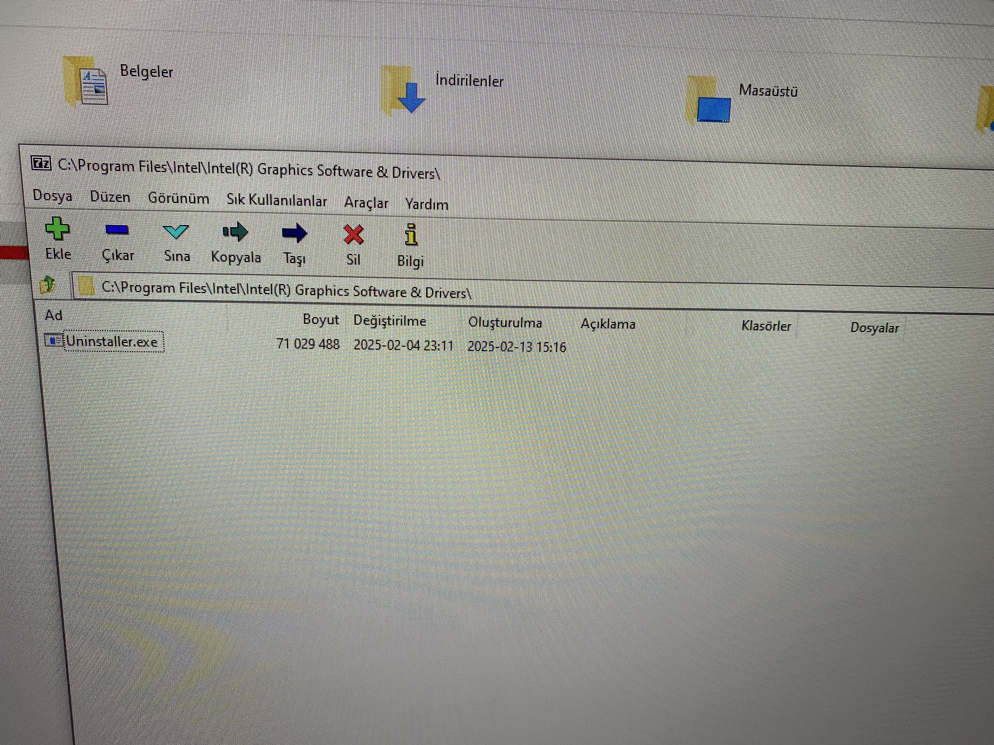

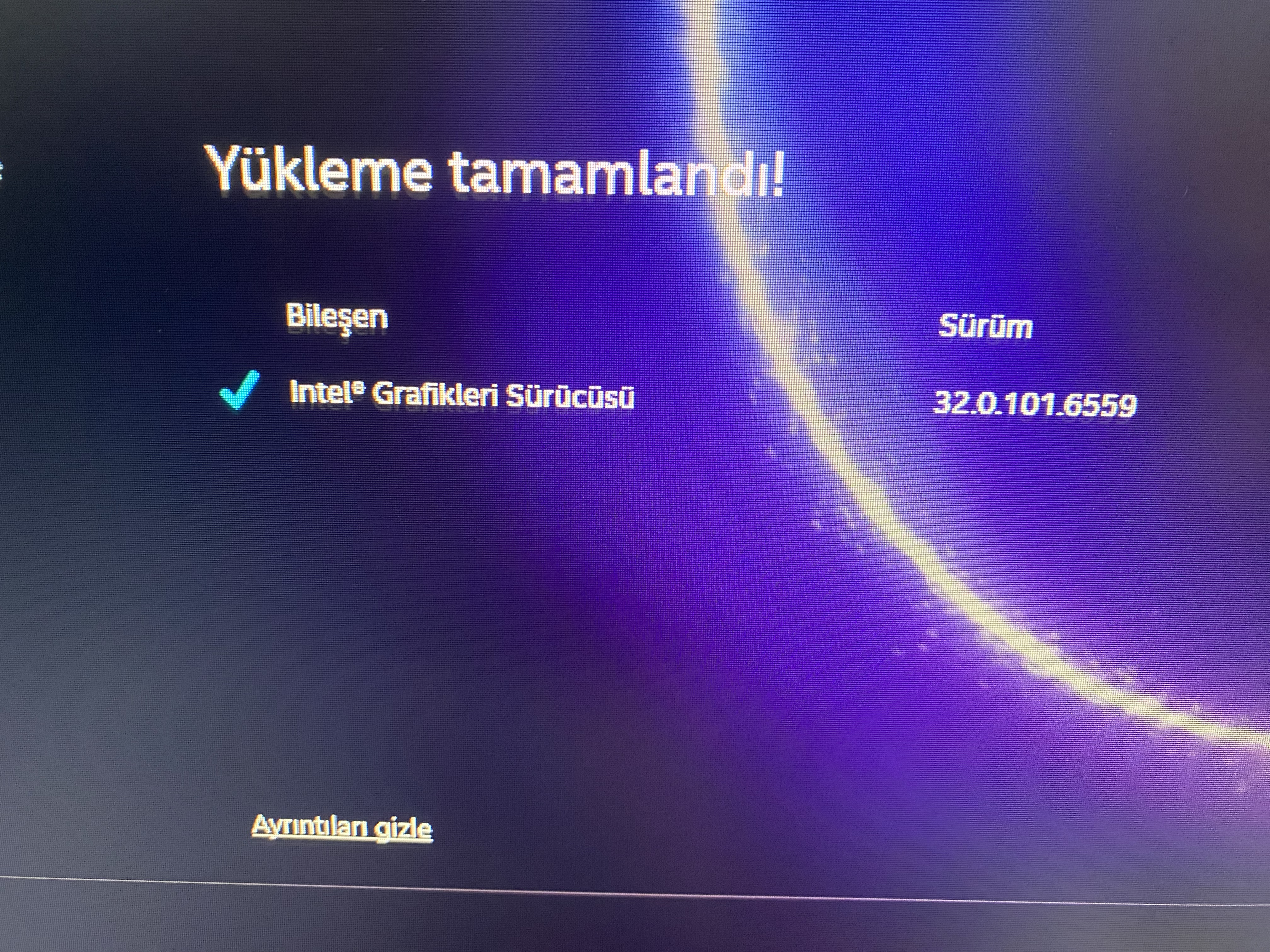

I installed the Intel driver 101.6559 but when I installed this driver my Intel software control panel disappeared from my computer I tried to download the latest older versions 101.6565 and 101.6259 still the same all my game profiles disappeared please help thank you

Thank you for posting in the community. Could you please try downloading the 7-Zip application and use it to extract the executable file of the Intel Arc Graphics driver? After extraction, you should find a folder named "Resources." Inside that folder, there will be another folder called "Extra." Navigate to the "Extras" folder, and you will see an executable file for the Intel Graphics Software. Please try installing it on your system and let me know the results.

I only found uninstall.exe in this file. Also, the application appears in the Windows control panel, in the uninstall program section, but I cannot find it as an application

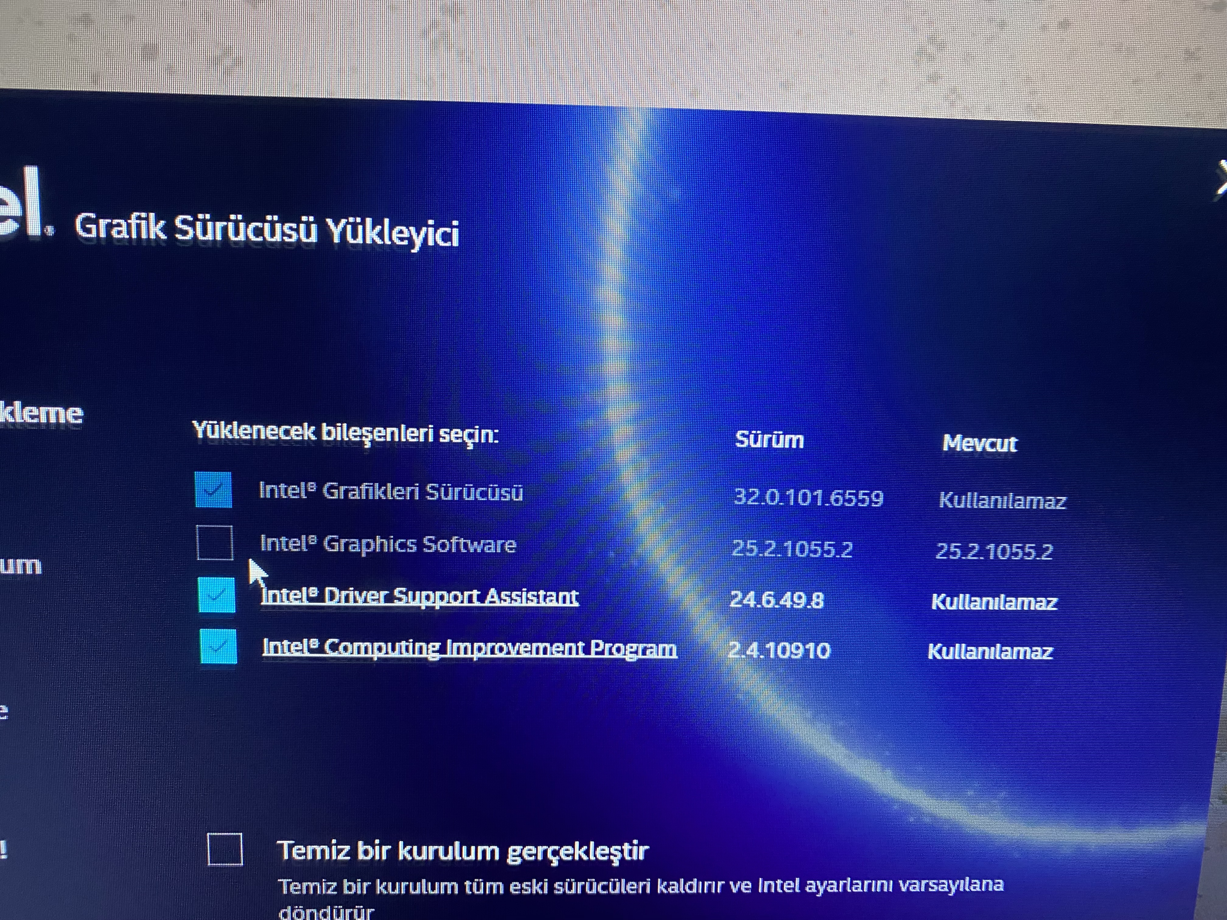

Why ı cannot click intel graphics software button during installing?

It seems there might have been some misunderstanding. I wanted to clarify the process for the driver you downloaded from the Intel website (gfx_win_101.6559).
First, you'll need to extract this executable file using the 7-zip application. Once extracted, you should find a folder named "Resources." Inside this folder, there will be another folder called "Extra." Navigate to the "Extra" folder, where you'll find an executable file for the Intel Graphics Software.
Before installing the Intel Graphics Software, please uninstall any existing version from your Control Panel. After doing that install the IGS alone only.
