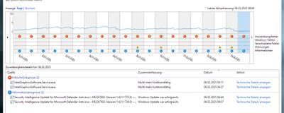

I am from germany and have the same issue everyday when shuting down my IntelNuc computer.
Reliability Monitor
Event log
Sysinfo
Driver
Installed Intel Software
It's very sad that Intel can't even program their own hardware properly anymore.
I don't want to complain, but when a company like Intel works so sloppily, it's no wonder that users prefer other, cheaper manufacturers. People buy Intel because of the quality, but it seems that it doesn't exist anymore!
