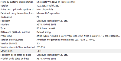

Thank you for the information. Upon checking the system report I noticed some things for instance,
  • The BIOS mode is on Legacy of which we recommend using UEFI.

wylath
11,180 Views
  • We recommend for the texture type of problem, a reinstallation of the game, can you complete it?
Yes it's already done.
Texture problem (video) : https://clipchamp.com/watch/WnqaXoKr3fJ
and my system is already in UEFI, otherwise I would not have managed to install windows 11 because I had switched the system to UEFI a long time ago, it is most likely just a bug that it is displayed in Legacy and not in UEFI in SSU Scan Information.

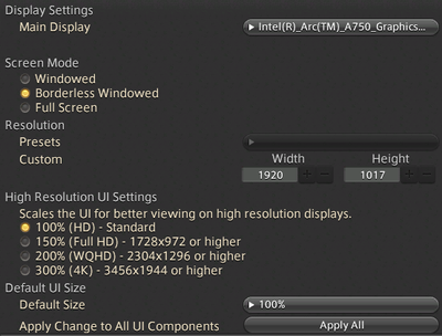

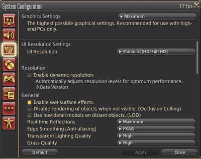

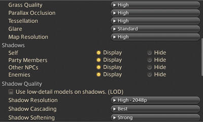

wylath
11,113 Views
Hey,
As I had already put in a previous post, here is the video for the fps : https://clipchamp.com/watch/G8Cau0tpqYt
You can see the fps (img/s) in the window to the right of the display, they are low as long as there are a lot of players and increase when the number of players to be displayed on the screen decreases. The fps drop is only present with a large number of players or objects to display.
I go through the display settings in the video to see what is put.
There is an in-game display limit for the number of characters and objects. She's maximum in my game setting. If I reduce the number of displays to the minimum I gain 10-15 fps in this kind of situation.
(It was the game setting I already had before with my old gpu and it worked correctly)
To make it easier for you, I add screens in English of the game setting.
wylath_0-1673090966367.pngwylath_1-1673090991023.pngwylath_2-1673091017148.pngwylath_3-1673091047050.pngwylath_4-1673091060680.pngwylath_5-1673091099986.png
LuisGustav_A_Intel
11,073 Views
Hello wylath
Thank you for the information provided, though please confirm if you completed the Clean Installation of Intel® Graphics Drivers 31.0.101.4032, and/or tested 31.0.101.3975
Additionally, about the picture files, there is a setting for frame rate, with 3 different options presented to you, can you try each one and provide the achieved FPS
Luis A.
wylath
11,069 Views
Yes I confirm I have completed the Clean Installation of Intel® Graphics Drivers 31.0.101.4032 and tested 31.0.101.3975.
For the 3 different options frame rate, I tried in a zone, here is what it gives:
None : 24-27 fps
Refresh Rate 1/1 : 24-27 fps
Refresh Rate 1/2 : 24-27 fps
Refresh Rate 1/4 : 24-27 fps
(Yes, it doesn't change anything regardless of the option chosen).
