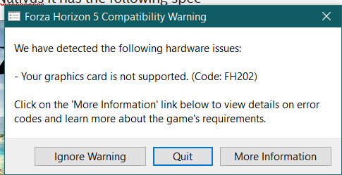

Hello, The same thing seems to be happening to me too
Last year I had an HP laptop using an i7 7th Gen 7500U processor with an Nvidea 930mx graphics card the game rendered well then but it stuttered a lot
but now I am using a newer laptop called Nativus it has the following spec
processor: i5 12th Gen 1235U
Ram: 16GB (comes with just 8GB)
Storage: 500GB SSD
Graphics: Intel(R) Iris(R) Xe
I tried running all my games and these are the errors I am facing with each game
They may play when I ignore the warning or something but they are bound to crash, not launch at all or have rendering issues
The games I tried playing were
- Spider man: Miles Morales (Upon reporting this issue this game wouldnt launch at all, I think I needed a system reboot but the results are similar to the original post about the rendering issues)
- Need for Speed: Heat (plays but fails to launch a few times at first... maybe after 3-8 launches/ after a reboot
- Forza Horizon 5 (crashes after benchmarking)
Other games that worked well:
PUBG, MK11 (even though it throws a warning), MKX, Valorant, Tekken 8, Call of Duty Advanced warfare
