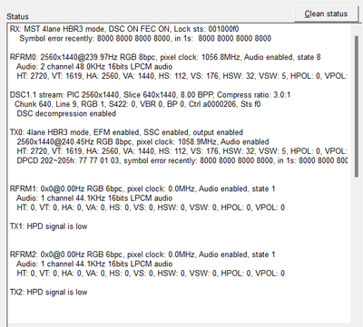

While I still can't offer a solution to the original problem, this is also interesting:
Dell WD22TB4 Dock review and Teardown
The fact that only 2560 x 1440 @ 240 Hz 8-bit with Dithering is available when hooking up the monitor via the DisplayPort connector also indicates that DSC is not being used or that the Intel JHL8440 Thunderbolt 4 controller does not recognize the need for DSC when hot plugged. The above signal is the maximum within the HBR3 protocol on DisplayPort that can work without DSC.
The Synaptics VMM5331 chip can usually be diagnosed with a tool. Version 9.1.7.0 of this tool is attached. If you connect the monitor via DisplayPort you can use the tool to see what is going on.

This is what it shows. Interesting that it show DSC is enabled as right now from the monitor at least it is disabled, maybe it is enabled from the DP port of the hub? Also it shows the same thing before and after restart of windows.

Interesting diagnostic result.
It shows that DSC is enabled within the dock between the Intel JHL8440 Thunderbolt 4 controller and the Synaptics VMM5331 DisplayPort 1.4 Multi-Stream Hub Controller, but not when outputting to the DisplayPort connector.
VMM5331:
Rx = Receiver (from JHL8440).
It receives a MST (Multi Stream Transport) DSC stream and then:
Tx = Transmitter:
This decompressed output represents 98% bandwidth usage of DisplayPort 1.4 HBR3.
Refresh rate, bit depth and pixel clock could only be increased (on the monitor) by passing a DSC stream through and not decompressing in the dock. Decompression should then be done by the monitor.
This would need to be investigated further with a Dell developer.
