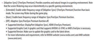

Hi Hugo,
This is what the manual says:
And I think in the driver's panel there should be options to enable the support of such feature like the one on the NVIDIA panel:
I am wondering how can I enable such feature on intel Arc?

Hello Bill_da_da
In the case of our Intel® Arc™ A770 GPUs, there are no other settings available and just by activating VRR, it should allow you to take advantage of the full refresh rate rate available for your monitor. To activate VRR follow these steps:
- Go to Intel® Arc™ Control(Alt+i)
- Select Display
- Select Per-Display Settings
- Select Enable Variable Refresh Rate
Hugo O.
