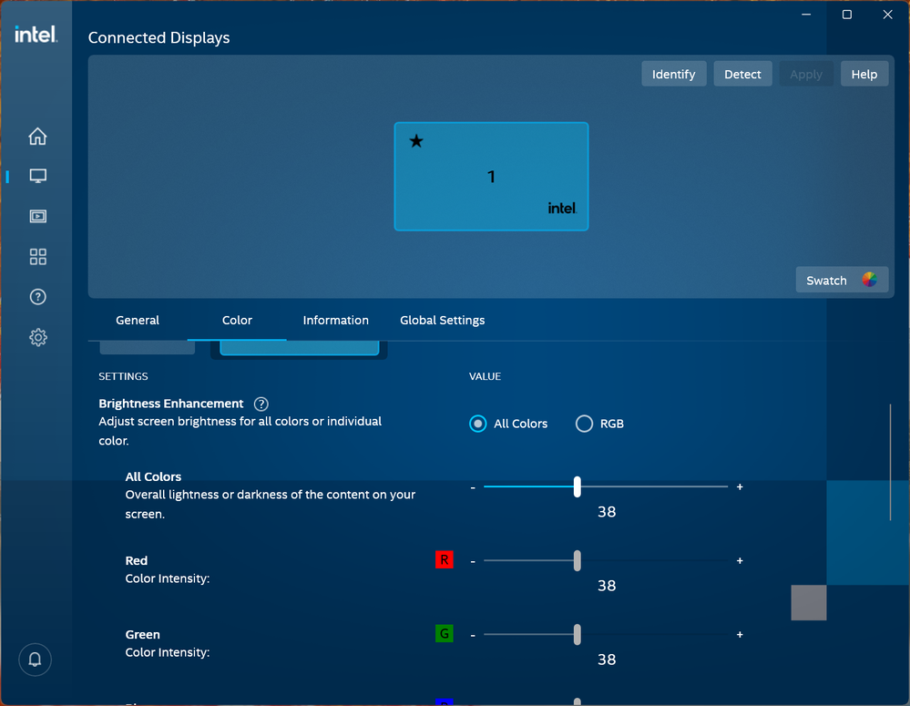

Having recently installed the latest driver "Intel® Arc™ & Iris® Xe Graphics - Windows*" (Intel® Graphics Driver 32.0.101.6458/32.0.101.6257) I've encountered a problem.
Using the Intel® Graphics Command Center, I have the display settings setup the way I prefer.
With the latest driver, the settings are not retained. On every startup, or if I connect an external display to the laptop, the custom display settings effect disappears. Only the actual display results are affected, the controls retain their custom values. If I click to change the controls, the display returns to the correct custom settings.
Display settings

Yes, the display settings go back to the default - but only the actual screen output - the control settings remain as I left them.
If I adjust the controls again, then the output changes accordingly.

Hi. Thank you for the response.
Unfortunately, I couldn't make it work. The "Windows HD Color setting" is not available on my machine.
Disbabling Asus Optimization service did not work either.
I appreciate the help provided all the same.

Hi. Thank you for the assistance.
I have managed to solve the issue, it turns out to be the settings on the laptop the was causing this problem,
and not related to the graphics software.
I apologize for the bother.

The issue is experienced in Asus ROG laptops being in a visual mode called "Racing".
This mode causes the Intel graphics display setting problems. To fix it, press fn + v to switch between visual modes,
until you reach the "Default" mode.
