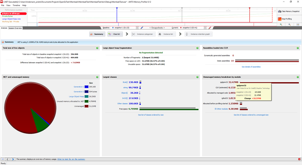

We are facing a memory leak when using .net Application (.net 4.6.1 C# Windows Forms with OpenTK GLControl) with Intel HD graphics (inside igdgmm32.dll). Our capabilities are limited, can you help further analyzing?
Preconditions
Intel HD Graphics
  • verified with:
  • Intel UHD 630 (Driver: 26.20.100.6911), Windows 10 => igdgmm32.dll
  • Intel HD 530 (Driver: 21.20.16.4542), Windows 7 => ig9icd32.dll
  • Intel HD 620 (Driver: 26.20.100.6888), Windows 10 => igdgmm32.dll
  1. Create Windows Form
  2. Add GLControl (make sure property "Dock" is set to "DockStyle.Fill"
  3. Shrink or grow GLControl on every frame
Note: when removing the dock-style setting, the leak does not occure.
Note: this is not representing the actual usage, this is just to make this issue occur more likely.
Screenshot of growing memory consumption in igdgmm32.dll

Below you find a Redgate ANTS Memory Profiler Result ("MemleakTest_ProfilerResults_101819.zip") and a CSharp Test Project ("MemleakTest.zip").
After starting the Test Project, the GLControl (UserControl as a Container for OpenGL Drawings) will start switching back and forth the Back and Front Buffer. By pressing the "s" key, a thread is started to Grow and Shrink this UserControl leading to the described MemoryLeak.
Please let me know if you need any further details or want me to re-transmit the files if outdated before investigating.
