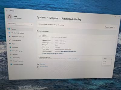

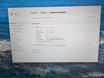

With the same exact laptop, port, adapter, and TV, I was trivially able to get 8k @ 60Hz to display perfectly on my Gen 12 Lenovo X1 Nano Gen 2 with the i7-1280p, as advertised. TV: Samsung qn800a.
An update to my system, which included a cumulative Windows update as well as an Intel driver update, broke this capability. Selecting the 7680x4320 option now results in a max of 30fps, and the resulting image is extremely blurry with a poor colorspace, YCbCr420.
It is obvious that the computer was using DSC before, and is no longer doing so. This is a major, critical regression. I spent $2500 on this laptop and $2000 more on this TV to use it as a monitor. Now it is totally broken garbage.
This is a critical, collosal, utter failure and I don't even know where to begin troubleshooting. I've tried resetting the TV completely (no use), tried downgrading the Intel driver (I'm met with errors if I go back too far, and the oldest working driver does not change the behavior, so it's probably an interaction with Windows).

Hi again -- just wanted to update you that I accidentally skipped just one version -- 1631 -- the very first driver that supports this chipset on Intel's page -- WORKS. The very next one (1660) and all the way to the latest 101.3222, are broken. They do not support the advertised output modes.
I can also confirm on a native DP monitor from Dell!
I refuse to believe nobody has ever tried an 8K TV or monitor with this ultra-common gen 12 chipset. This is seriously bad, guys. Seriously bad -- what's going on with the driver QC on 8K setups? I have attached pics now, showing the one working version (above) and all versions since (bottom, broken!).
This obviously is a critical problem that really needs to be fixed. It happens with 2 monitors using completely different setups.
No, that second image is not a blurry shot from my camera. It really does look that screwed up. And yes -- it only shows 3 refresh rates, and 60Hz isn't among them. Clearly DSC is not getting enabled in later driver versions, making the spec misleading on your Arc page for this chipset for all later drivers than 1631. https://www.intel.com/content/www/us/en/products/sku/226253/intel-core-i71280p-processor-24m-cache-up-to-4-80-ghz/specifications.html#specs-1-0-4
