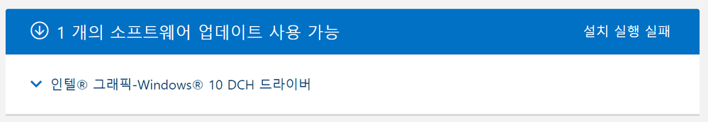

캡처1.PNG안녕하세요.
Surface Pro 7에서 첨부와 같은 Update가 계속 실패합니다.
확인부탁드립니다.​

User1592672760333169
5,416 Views
I have the same problem.
And I did apply the latest Surface Pro 7 drivers and firmware update (latest as of 6/10/2020) as you suggested.
Intel Driver and Support Assistant continue to pop-up notification, and report that I'm missing 1 available update for "Intel AVStream Camera". The weird thing is that it ask me to download the "Intel Graphics - Windows 10 DCH drivers", which does not contain this camera driver. And installing it again and again does not help with the problem.
Multiple people reported this problem. Intel AVStream Camera driver is no where to be found on Intel website, even if I want to install it manually. Something wrong here.
