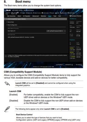

7/16 Update 2:
Item 1: from the ASUS BIOS Manual, page 75: "Launch CSM will be set to disabled and cannot be configured when using the integrated graphics."
If this is the case, I will never be able to boot using integrated graphics and the SATA hard drives together!?
Item 2: I don't understand the error in the attached image file. Does this mean if I'm using CSM, the integrated graphics are disabled? It does not state that in the motherboard or BIOS manual from ASUS.
Thoughts?

Hello chvroman,
Please try the following steps and let us know of the outcome:
  • Check if you have CSM enabled in BIOS. If you do, enable the iGPU Multi-Monitor setting and then get into the OS and check if you can install the graphics driver with both enabled.
  • Try to reinstall the OS without the graphics card to test and confirm if CSM is active or not.
There could be a misconfiguration causing this, and you may need to check with the OEM in order to configure the hybrid graphics.

on such a new system you should not run csm mode but uefi (with all the secure boot whistles on top)
Isn't there an option in your bios to enable both dgpu and igpu, setting either as first boot device, so iGPU or PEG.
There should also be an option in asus bios (same place where you set your graphics boot device) for having the igpu standby so it would work without a screen attached even.
That way both dgpu and igpu can be used simultaniously.
