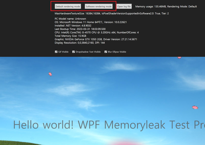

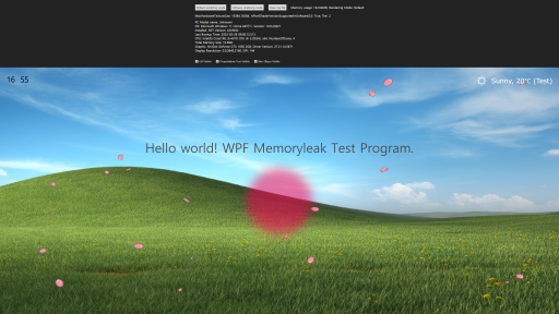

For your information, I attached WPF test program to remake this issue.
When running the "WpfMemoryLeakTestApp.exe", the used memory log is written in file named "WpfMemoryLeakTestApp_Log.txt" per 10 seconds.
To review this issue thoroughly, please check this log after running the test program for more than 2 hours.
Also, I attached the log of the WPF test program when running for more than 2 hours on PC (1) with the issue and PC (2) without the issue. The names of the logs are like the following : "PC1_ERROR_LOG.txt" and "PC2_NORMAL_LOG.txt", respectively.
PC (1) is tested with the graphic driver 31.0.101.3790 ver. Installed and, PC (2) is tested with the same graphic driver installed in PC (1).
From these logs, you can check that the memory in PC (1) is used more than twice the one in PC (2) and also the memory in PC (1) is increasing, but PC (2) is stable despite of graphic driver with the issue installed.

Q3. Can you provide specific steps on how to replicate the issue and how to use the files that you provided?
A3. First, please download 'WpfMemoryLeakTestApp_exe.zip' to check the memory leak test program.
'WpfMemoryLeakTestApp_sourcecode_vs2022.zip' is the source code(which is developed with Visual Studio 2022) file of the test app.
I build this test program with .NET Framework 4.6, x86 build, and C# .WPF (It is made as same environment with the actual KIOSK program.)
[How to run a test app]
a) A test starts by running the app. - That's all! As it is the test program, I made it simple.
The followings are some additional information for your reference.
b) The memory usage is written in log file 'WpfMemoryLeakTestApp_Log.txt' per 10 seconds.
Please check the log data after running the app at least 2 hours for the detailed test.
c) You can switch H/W and S/W rendering by clicking 'Rendering' button on the top of the program.
