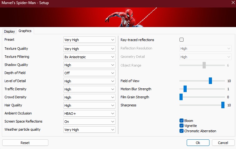

I'm experiencing a recurring visual issue in Spider-Man Remastered on my Intel Arc B580. After playing for some time (usually around an hour), explosion particle effects are replaced with black squares that contain smaller white squares inside — almost like missing textures or broken shaders.
I've tried the following:
Disabled film grain
Turned off all upscaling (FSR/XeSS)
Disabled V-Sync
Cleared shader cache manually
Verified game files
Despite these steps, the artifacts always return after some time in-game. Temperatures and VRAM usage are normal.
Any suggestions or fixes would be appreciated!

- Kindly share some screenshots and recordings of your game settings so we can replicate and check the issue on our end using the same settings you use during gameplay.

11) Attached

I reinstalled the drivers with DDU and made sure I have the latest version, but unfortunately, the squares came back again after some time. I usually spot them quickly during demon fights or when using web grenades. Actually, I finished it a while ago, but I’m keeping it installed in case we can figure out a solution to this issue.
