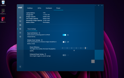

I think I found the main culprit here. And it could be both Windows and Intel driver but not sure. So, there is an option regarding "Content adaptive brightness control  (CABC) in Windows 10/11, completely hidden inside the brightness level controller in the Settings app.
And here it is:
Disabling it fixes all the issues for me. No more automatic changes to contrast level which essentially made the screen look faded or washed-out previously.
Interestingly, after disabling this windows setting, enabling/disabling 'Display Power saving mode' has no effect on the screen anymore. I can now open Command Center without causing faded colors 😀.
Its definitely a mix of both CABC and DP saving mode conflicting each other's algorithm. One makes screen darker other sees that and makes it even more darker/colorless and ends up being total mess. I don't know how to even make conclusion here as if is it Intel or Windows causing the problem.
And here it is:
