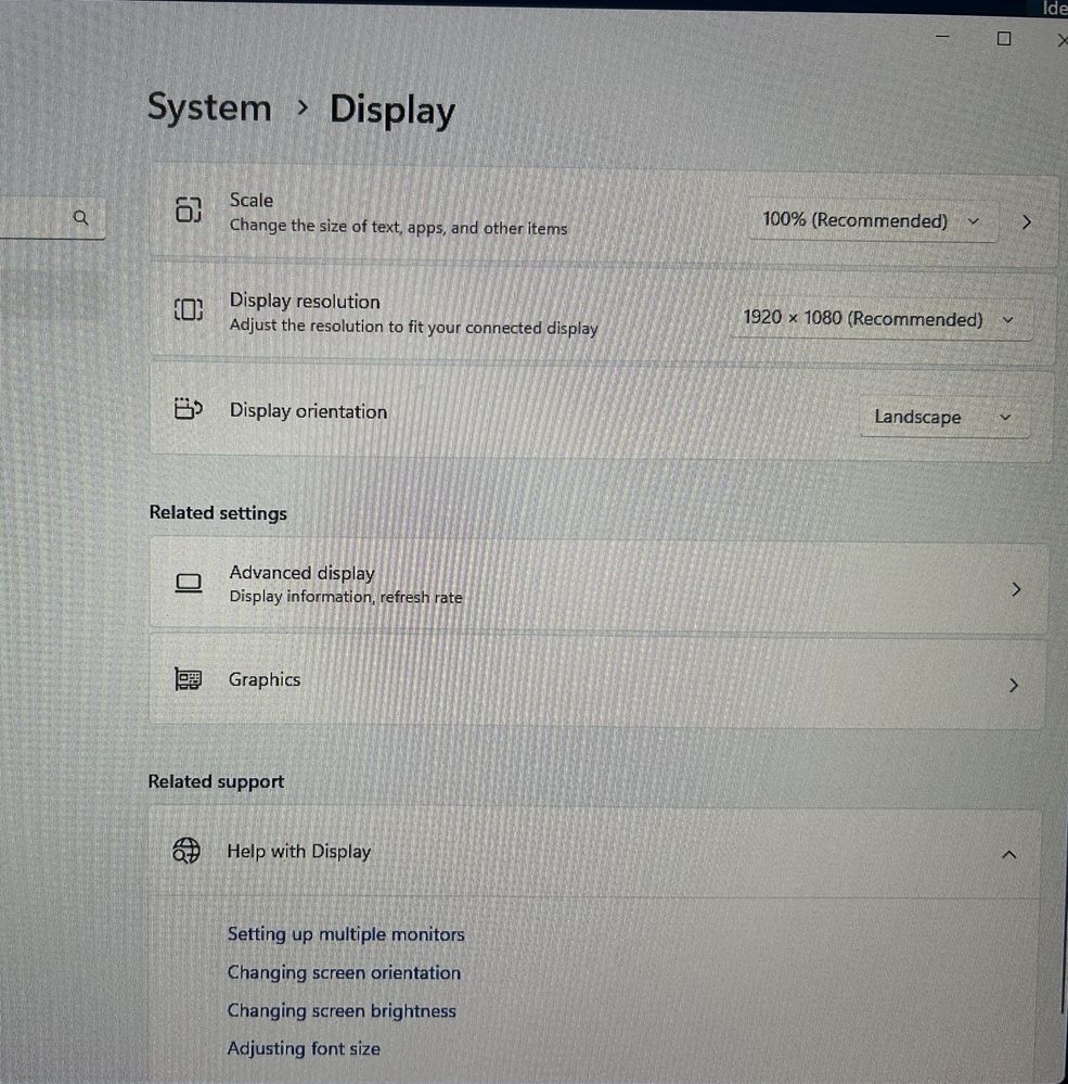

Greetings! I followed this thread to this point with CABC. My laptop does not provide this option on the Display function. I have a down arrow like yours but nothing opens. Any ideas? I am having the same frustrating faded-colors issue. Thanks!
You don't have this?
Honestly, I'm not sure what makes this setting appear or not appear. Could you check online how to disable CABC through registry?
Edit:
This issue can be solved in two ways: Disable DPST or CABC. The problem only occurs when both are active together.
The one on the GitHub link uses a registry to disable DPST (which works fine but if you ever clean install Intel graphics driver, you must do it again).
