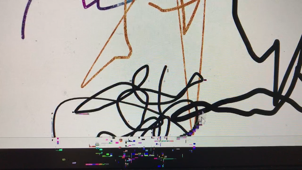

Fully reproduced video. I have a thinkbook15 laptop with an intel xe graphics card.
When I draw in the office suite (including word, powerpoint, onenote uwp), there will be flickering black dots around the track as shown below. Even when I draw down to the taskbar, the taskbar changes color and flickers.
The system version I am using now is Windows 10 LTSC (due to the regulations of my company, I cannot use the standard version of windows)
This problem occurs whether I use the graphics card driver from the manufacturer (version number 30.0.100.9955) or the latest official intel driver (30.0.101.1960)
But when I uninstall the intel xe graphics card driver and use the windows default display monitor, this phenomenon does not appear, so I can conclude that this is a problem with the intel xe graphics card driver.
A fully reproduced video has been added to the attachment.

1.This problem has been present since I got the computer from the company (probably 2021.7), but since I didn't need to use the drawing function at the time, I ignored it.
2.There are no other issues with the graphics card.
3.I don't think there is a problem with my embedded display. There are two reasons as follows. First, I tried to uninstall the Intel xe driver, and the problem was solved, so I think the problem lies in the driver. Second, I tried to install the latest (21th2) home version of windows10 on my external driver device, the problem was also solved, but due to my company policy, I have to use windows10 LTSC on the laptop, I think the drivers have some problem on windows10 LTSC.
4.Not exactly, also occurs on onenote uwp, and strangely the problem doesn't occur when I use "pencil" to draw, but when I use "pen" it does.

Sorry, I can't test the external monitor because I don't have an external monitor around me, but this problem won't happen when I use my mobile phone remote desktop to connect to my computer.
But today I found something interesting. When I use the driver with version number 27.20.100.8873, this problem is solved! So I'm sure there are some problems with the driver. However, the driver of this version is beta, which contains some other errors. I still hope you can report this problem to the development engineers so that they can fix it in the next version. Thank you.

Hi Jean,
Here is the reproduce procedure
1. Install windows10 LTSC(1809)
2. install office2019 or onenote uwp
3. install intel xe driver(30.0.100.9955 or 30.0.101.1960 or other version, not 27.20.100.8873)
4. open word or onenote,use "pen" to draw

We have tried to replicate the issue using the latest Windows 10 Build; however, we were not able to do so. We believe that it has been corrected by Microsoft on the new Operating system releases. My recommendation is to update the operating system to the latest build, but as you mentioned that you are not able due to company regulations. So contact Microsoft, as we cannot see the issue in the new Operating System.
