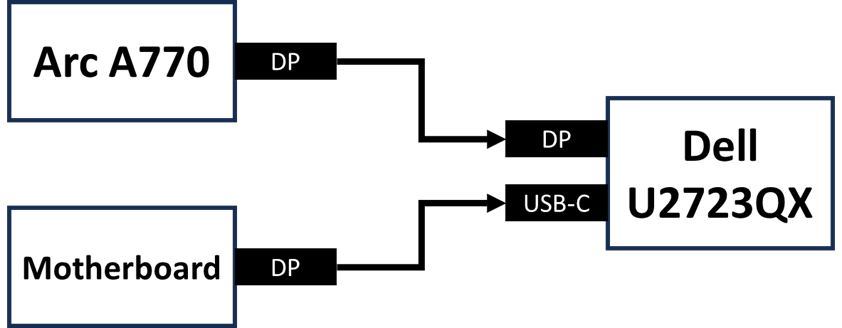

The transmission of real RGB 10-bit at the maximum resolution and refresh rate of this monitor is therefore only possible via the DisplayPort connection. The Dell U2723QX is certified according to VESA DisplayHDR 400. With HDR activated, the Intel Arc A770 can output a signal corresponding to the monitor's certification with 4K @ 60 Hz RGB 10-bit HDR Coordinated Video Timing - Reduced Blanking (CVT-RB) via the DisplayPort output. Is this not suitable for your purpose? For a more detailed analysis, please create a Report for Intel Graphics Drivers and attach the file here.

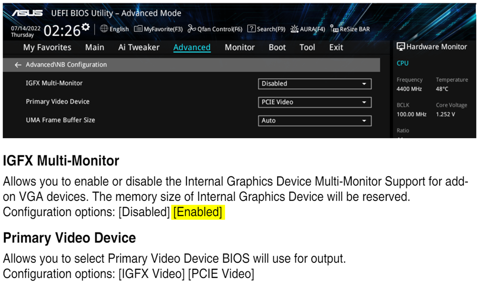

Your AMD Ryzen 9 7950X (AM5 Raphael) processor is equipped with integrated graphics. The motherboard is an ASUS TUF Gaming B650M-Plus WiFi with these ports:
  • 1 x HDMI 2.0 TMDS
  • 1 x DisplayPort 1.4 HBR3
To use those ports with the integrated Radeon graphics for less demanding rendering tasks, it must first be activated within BIOS:
Then connect a bi-directional DisplayPort > USB-C cable (e.g. this one) to the USB-C input of the monitor (connector #5 on page 12 in the PDF manual)

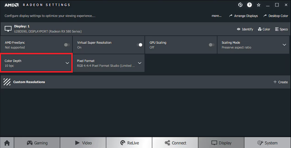

After installing the AMD graphics drivers in Windows, you can then use the Adrenalin software to adjust the color depth for this DisplayPort output, hopefully the same as what your roommate has. Alternatively, use AMD Radeon Settings.
Please note in the linked articles that it does not work without restrictions even with AMD: "The software application must be running in exclusive full screen mode, otherwise the image will be rendered in 8-bit mode."
