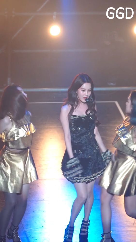

i5-11300H (Iris Xe Graphics)
OS: Win10 20H2
Driver: latest 27.20.100.9316 (3/3/2021)
evr (dxva2):
evrevr
d3d11:
d3d11d3d11
the image seems a bit red when using evr, see the screenshot.
i think problem is in driver. please test the attached file.

Laraine
9,443 Views
Thanks for your reply first. please check the attachment.
  • Are you using a specific video application for rendering or edit videos? If so please provide the details.
im using directshow players, mpc-be and potplayer, and a tool GraphStudioNext
thay display same result
  • Does this happen with all the videos or images? Is there any other color affected for example the home screen colors are also different?
Only happens on this video.
no any other color affected
  • I noticed lags on the video you sent is that part of the problem?
yes

Laraine
9,415 Views
Hi
I tried latest Graphics Driver from Lenovo, same result.
And i let many other people who owns intel kabylake, coffeelake, icelake, Comet Lake... test, they got same result like me.
And to help you replicate this issue, i made full records and steps, please see the .txt file in attachment.
i think i made it clear now. 😁

Laraine
9,341 Views
Hi
the issue occurs in this video clip only.
and i tested on nvidia/amd gpus, they work fine
