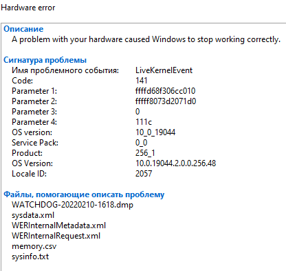

i5 12400 uhd730 constant crashes(C&C Generals Zero Hour)during game screen freezes in randomly times and throws it to the desctop with the inability to return to the game,but at this time game works,i hear sounds.every time have to end process in task manager.played on 10400 everything was perfect.other games is ok.(win10 21h2/30.0.101.1191)please optimize uhd730 driver for old games or write a solution

Thank you for posting on the Intel® communities. I understand you are having issues with the Intel® UHD Graphics 730.
1. Run the Intel® System Support Utility (Intel® SSU) to gather more details about the system.
2. Was the game working before on your computer? If so, when did you notice the issue?
3. Are there other games affected? If so, which games?
4. Can you take a picture of the task manager (performance tab) while you play the game?
5. Have you performed any changes at the BIOS recently?
Deivid A.

Hello Deivid..problems started after building a new computer with 12400. before that everything worked perfectly on 10400. other games work fine, but I don’t play them, they are very heavy for UHD graphics. bios set to default. I am sure its a UHD730 driver problem.excusme but if intel also will not optimize drivers for future desctop video cards, then I definitely won’t buy 😞

Thanks for the information and pictures provided. In this case, please try the following:
1. Try with the graphics drivers provided by Asus (Version 30.0.100.9833). Please check with Asus for installation steps:
2. Try with the new BIOS version (Version 1009), Check with Asus for instructions:
3. Try to perform a clean reinstallation of the game.
4. I know you are up to date, but try with a clean install of the Intel drivers:
5. Try to check with the game developer to confirm recommended settings.

after game crash i see inactive desctop with game sound,but the video was recorded this moment as a black screen.with asus driver is all the same.I will continue to fix the problem

yes i installed the asus driver. the game was downloaded from free sources, we have been playing it for about 10 years without any problems. this game has mod contra007 they are created on the same engine.i play both of them, hold tournaments, etc. and both versions of generals have the same problem! only this game does not like my new computer. I have no problems in other games or benchmarks, memory, cpu, ssd, I have stress tested everything and I have no other errors! this is a very old game created on directx 8, everything points to some kind of incompatibility or drivers.error also points to video card problems. I'm trying to explain to you that nothing has changed for me except for the motherboard and cpu. In other games and programs, everything works stably.as soon as I turn on the generals, I already see lags in the start menu,this is not normal, I played ideally on i7 3770 and i5 10400..Well,the bios will be installed after i buy the ups.always had asus and intel for the sake of stability, which do not need to be modified..If you have already checked the game with your 12400 and everything is ok,write me your windows version?

Thanks for your patience. Based on the research, I would like to confirm the following:
1. What is the resolution that you are using in the game? Can you try the resolution 800x600 for testing?
2. Are you able to run the game from an Official source like EA, STEAM?
3. This game needs to be patched to be played on Windows 10 since it was released for Windows 7. Can you check with the game developer to confirm the right settings for you?
4. Try to use d3d8to9-wrapper, which improves the compatibility and stability of the game significantly by converting all Direct3D 8-API calls and low-level shaders to equivalent Direct3D 9 ones.
  • Download the latest version of d3d8to9 (see file attached)
  • If you also use Gentool: rename the file from d3d8.dll to d3d8x.dll to make sure you don't overwrite Gentool.
  • Place the file in the game directory of both Generals and Zero Hour.
  • Play the game.

I bought a video card, now everything works fine. I hope your solution helps someone else. anyway Deivid thank you very much.you spent so much time on this problem
