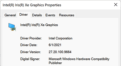

- After rebooting with Microsoft Basic Display Adapter in Device Manager - Photoshop crashes
- After rebooting with Intel(R) Iris(R) Xe Graphics (6/1/2021, v. 27.20.100.9664)* - Photoshop crashes
- After rebooting with Intel(R) Iris(R) Xe Graphics (12/3/2021, v .30.0.101.1991) - Photoshop crashes
*That's the version of the driver that loads from the HP site's video driver download
>>"3. Right-click on Microsoft Basic Display Adapter >> Update driver >> Search automatically for updated driver software.
4. Reboot the computer."<<
Step 3 reports that the best driver is already installed. However, after a reboot, Intel(R) Iris(R) Xe Graphics (6/1/2021, v. 27.20.100.9664) is shown in Device Manager. (Should I again install the later (12/3/2021, v .30.0.101.1991) version now?

"after a reboot, Intel(R) Iris(R) Xe Graphics (6/1/2021, v. 27.20.100.9664) is shown in Device Manager. (Should I again install the later (12/3/2021, v .30.0.101.1991) version now?"
This is a common recurrent behavior of Windows* Update Service and it is due to how Windows* "interprets" which "the best driver" is for a system. In those scenarios, the recommendation is just to install the latest DCH driver over the existing driver (no need to follow the clean installation steps). This is documented in the following article: Windows* Update Reverting to an Older Graphics Driver.
